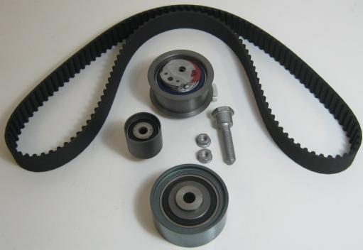

The cambelt tensioning kit '03G 198 119 A' consists of the following (see list and picture - some parts listed twice as they have different part numbers)):
  • Toothed belt;
  • Tensioning roller;
  • Hexagon collar nut;
  • Relay roller;
  • Relay roller;
  • fixed bolt, hex head;
  • threaded pin;
Fourth, is this the correct kit or anything missing?

That looks like the correct kit. There are 2 kits for the 2.0 TDI PD depending on year.......pre 2006 models have a slightly different size bolt for one of the rollers. Your car obviously firmly falls into the post 2006 model category.

As long as you buy a full kit (including rollers/tensioner) then you won't go far wrong. I'm pretty sure the tensioners in all the kits are made by the same company in Canada. The rollers are probably the same.
Engine code is BKD870763 if anyone can clear that matter up for me (or what size bolt I need on this engine).
You've definitely got a 16v then. The change over date for the new roller bolt size was May 2006, So yours will almost certainly have a M12 bolt on the relay roller. I say almost certainly, as your car could in theory have had a replacement engine in the past from an earlier car. But this is highly unlikely without you knowing.....especially if you have owned the car for a long time.

A word of warning, we changed a belt (kit & water pump) on one of these engines a while back, we even replaced the tensioner fixing stud at £2. The stud failed leading to a £6000 bill for a new engine. Though if the belt didn't get the engine it would have only been a short time before it ingested its manifold flaps.
