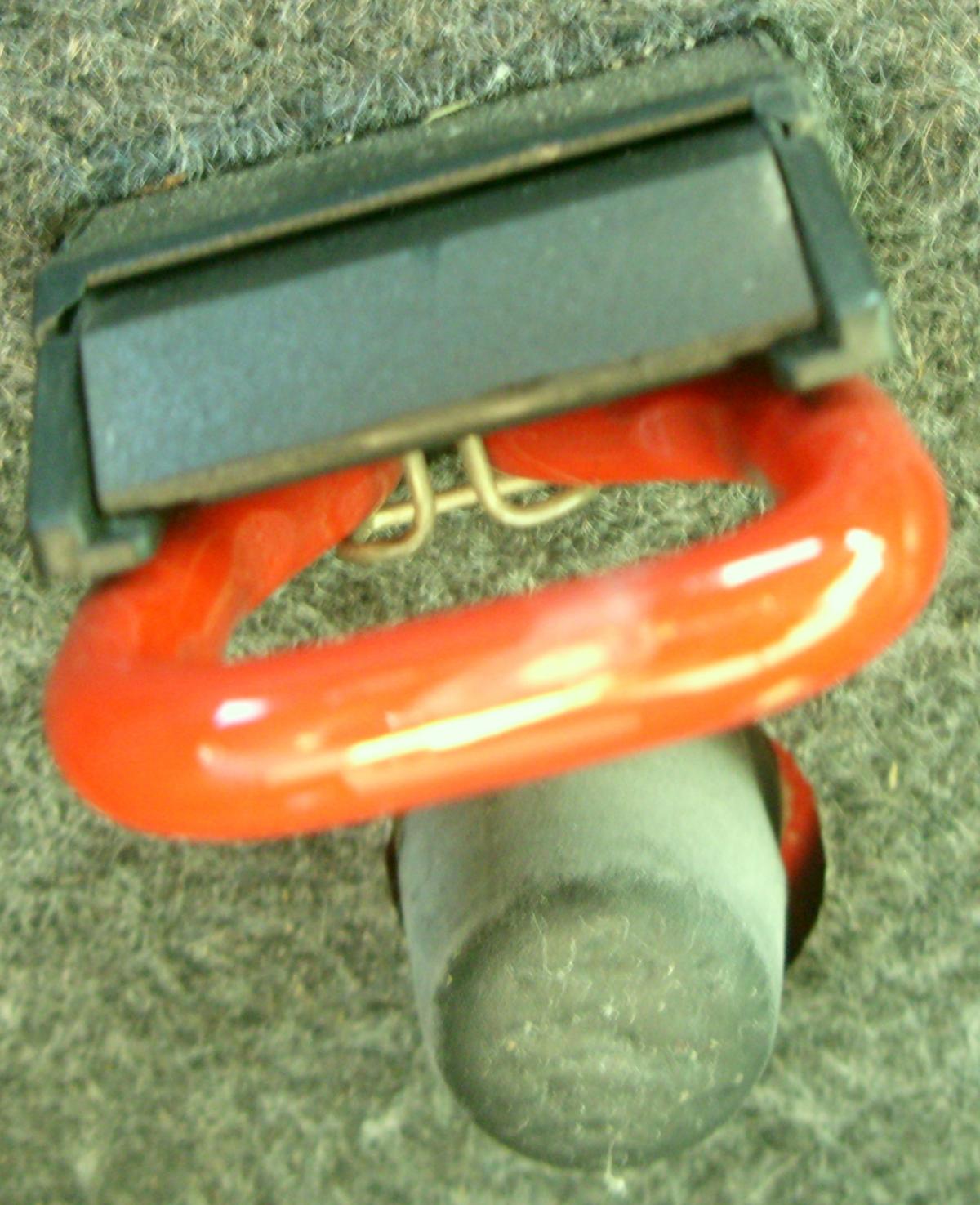

Rear seat behind driver.
Drop back downwards so it sits on bottom part.
Look towards rear wing.
Picture attached.
My warning light has now started intermittently flash on dash-board.
Removed switch, dismantled (easy enough), pressed the two little metal contacts downwards (carefully), reassembled.
This seems to have done the trick, time will tell. LOL
