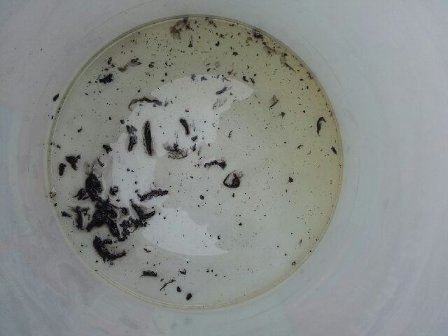

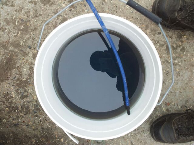

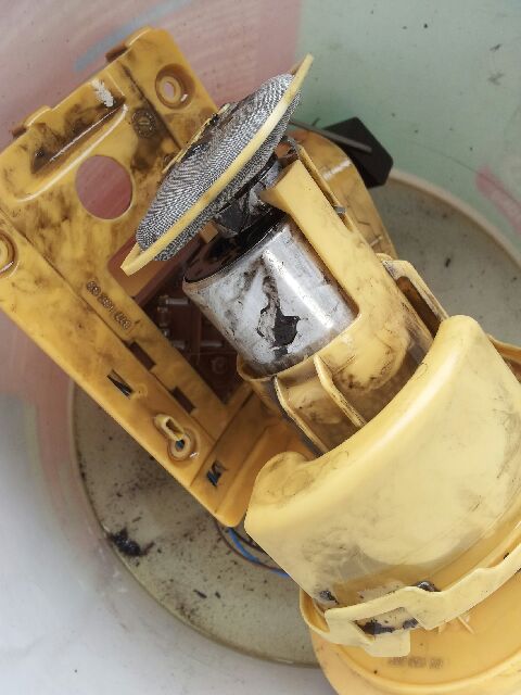

Failed to start on the next day same symptoms as before. Had the mechanic come to mine, who got it started again, and drove it back to his workshop. The mechanic did some tests on the tandem pump and the pressure was below spec at 1.5 bar at 1600 rpm, forgive me I can't remember the exact figure, and ok at 4000 rpm. He replaced the tandem pump, started the car regularly over the next few days all OK. He thought that there might be a problem with oil leaking into the diesel through this pump. I drove the car back and left it overnight. It failed to start easily the next day again but it sounded different so I persisted and after about 10 second it started. So i took it back to the mechanic again. He checked the fuel system and thought that the fuel was not right and there was contamination in the tank, tank pumpp and filter housing, see photos. So he drained and cleaned the tank, new tank pump, fresh diesel, new fuel filter, timed the injectors. Started the car. Left it for 48 hours and it started fien again,so I collected it. Drove to Bristol, 50m, all OK, then back east on M4. Car power failed completely at 70 mph after about 6m, no mechanical bad noises. Pulled over to hard shoulder. Tried to start but rough and lumpy. Called RAC and waited. 1 1/2 hours later he arrived and managed to start the car after cranking for 10 secs, so we drove to Leigh Delamere services. Ran daignostics and came up with the attached fault codes. The cruise control ahs not bee working for many months. post-104390-0-01117600-1370720373_thumb.jpgpost-104390-0-11163400-1370720374_thumb.jpgpost-104390-0-92075200-1370720374_thumb.jpgpost-104390-0-04155100-1370720376_thumb.jpgpost-104390-0-30586100-1370720377_thumb.jpg Fault codes: 11804; 16685; 01135; 00895. Restarted car and proceded for about 6 miles when the car failed again with RAC man following. There was a brief period of lack of power ie hestiation before failure. Towed the car back to the mechanics workshop. I gave him the fault codes and one relates to injector 1 misfiring. I though that this might simply be due to the roughness when trying to restart after the failures. He then said that I might have worn through a bucket under the cam, which was a problem he had with a golf mk4. The engine is mechanically very quiet. Oil level is not fluctuating and is not too low. We're starting to look at serious money here and I need some help from the forum. Personally, I might be in denial, but it looks like possibly bad fuel and fuel starvation. What do you think?

The tandem fuel pump, fuel filter and tank lift pump has been replaced, tank cleaned and fresh diesel used. It is an interesting idea that the supply to the tank pump itself might be internittent. I believe that there is a relay by the battery, which is fairly cheap to replace. The mechanic did say that before he replace it it was pumping hesitantly and he put this down to the crud in the fuel blocking the pump filter, but it could be the power supply! I've also found someone who had the injector fault due to a poor connection on vacuum side of the tandem pump. I'm going to try all the simple stuff first. There is no evidence of wear on the camshaft. Another possibility is that the retiming of the injectors may not be quite right and this can lead to warm running problems. I don't think at the moment that it's the dreaded injector problem. Can anybody definitive state that Octy BKD engines, mine's 2006 reg, have only Bosch PD injectors?
