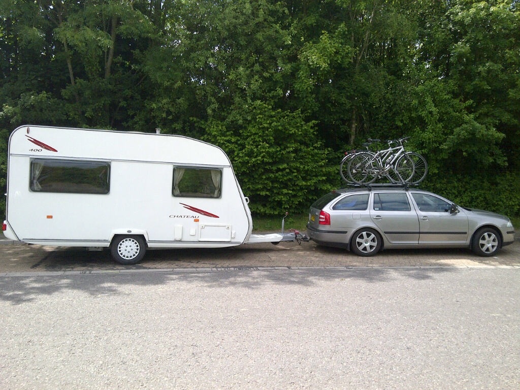

My springs are healthy, don't seem to have a problem, good load in the back after a 2 week holiday, 75kg noseweight and also remember the noseweight becomes part of the cars payload when hitched up.
Thanks Yorkshire, that pic is useful for comparison. My setup is similar to yours, but I reckon mine is looking lower at the back (although it's hard to compare exactly).
