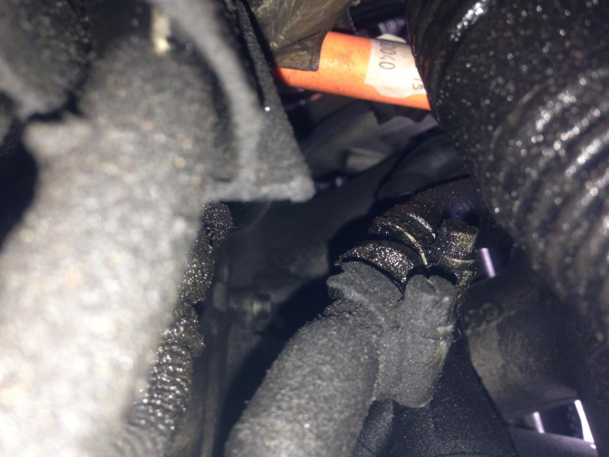

Evening guys im looking for a little bit of help/ advice on what the part number/ name of a pipe i have found a bodge on :( some nugget has used a peice of copper brake line and 2 jubilee clips instead of replacing it ....

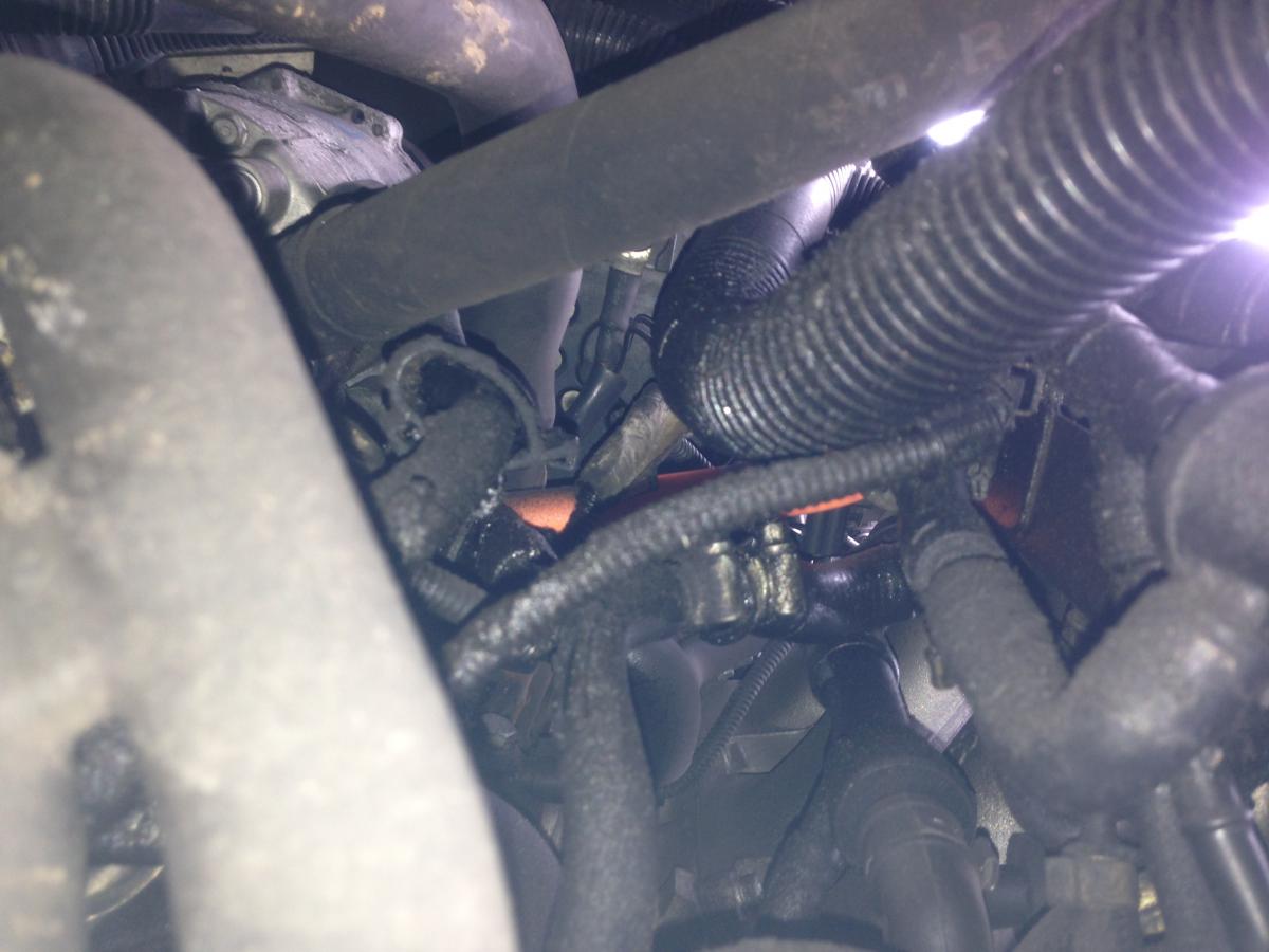

Pics are too close for me to tell, is it your breather pipe/s? Does it connect to the Y pipe on top of the cam cover?
As above, where is that pipe? Doesn't look to be one of the boost pipes

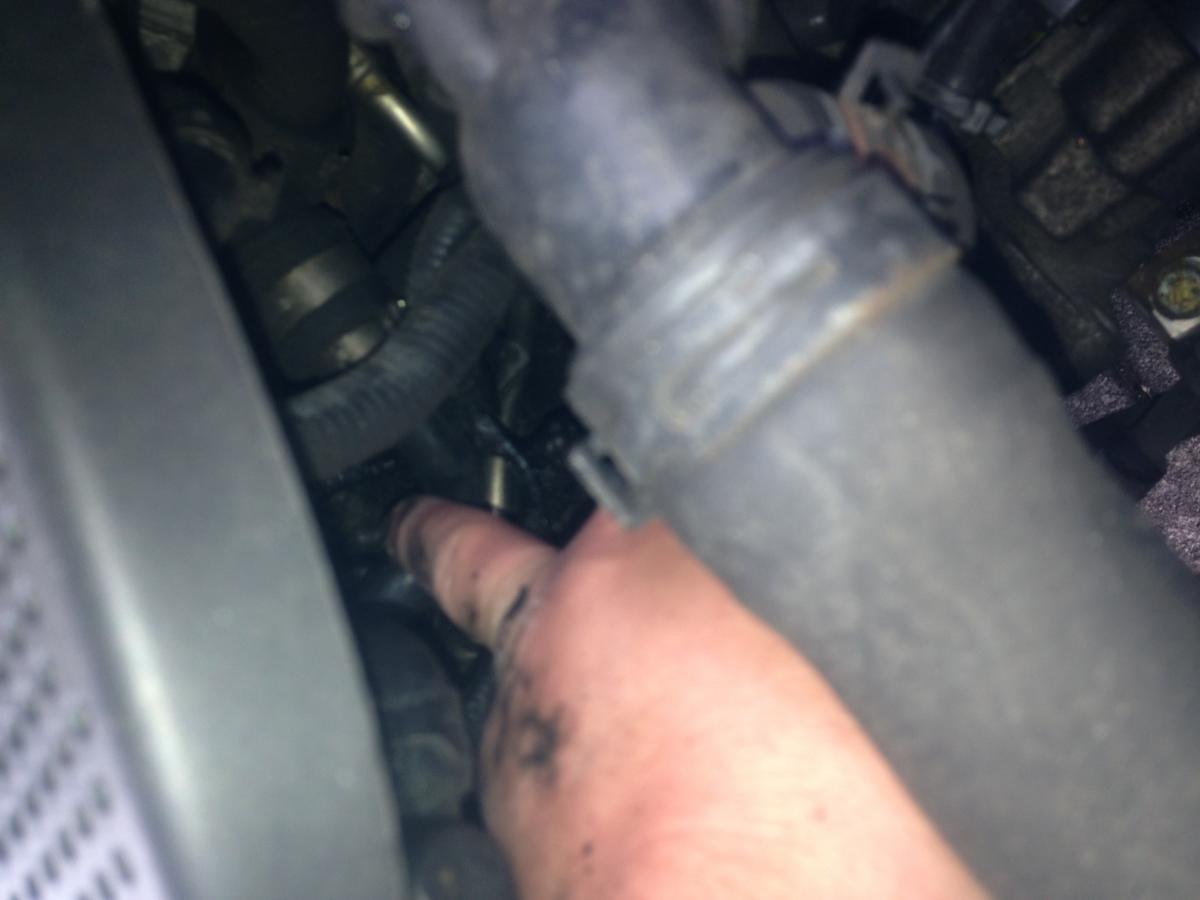

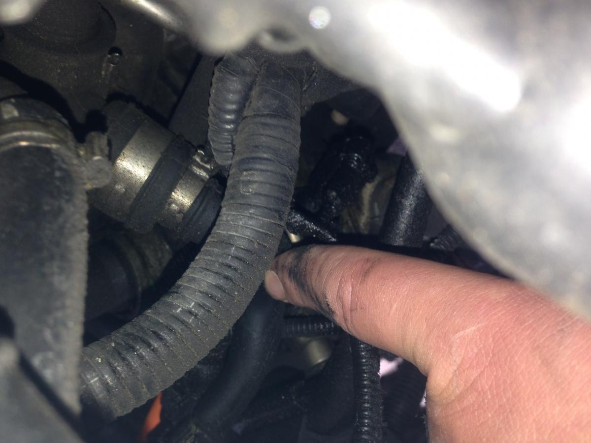

I reckon you need number 10 and while your there you may as well do 5,6,9a, and possibly 13a all connected together, and if one has gone the others ain't far behind. i'm pretty sure the last pic is the PCV valve which is number 5 and 6.
6 sits inside 5 and you've got your finger on number 10.
Can't look any more my necks hurting from twisting it lol
Get another pic if possible and I'll tell you exactly which pipe you need,
Unfortunately I can't get a better pic as I can't get the phone far enough back to get a wider angle ... The pipe that mad split is the one I have my finger on that goes to the reducer does anybody have the part numbers etc ?

Aye thats the one
Like I said check the other as they are all connected and if that one is gone the others will be on their way
