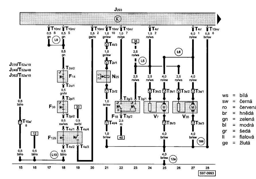

There are 3 thermostats that play a role-
F14- coolant temperature-- open circuit above 119°C
F38- outside air temperature-- open circuit below 5°C
F18- thermostat for turning on radiator fans
and a pressure sensor:
F129- pressure sensor for aircon system
(This is for a '99 TDI with AGR engine)
I'm not an expert on this, but if any of these are failing, then the aircon computer isn't going to let things run.
