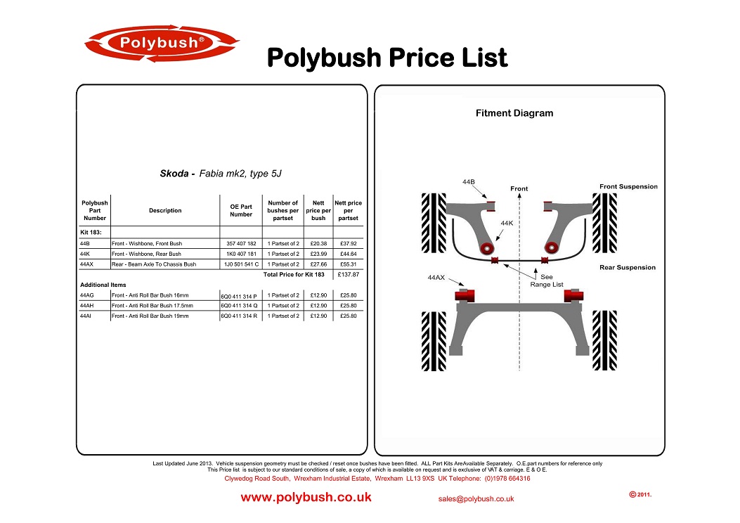

Skoda Fabia II 5J Polybush kit now available
We're pleased to say that Fabia II owners now have a polyurethane replacement bush option for their cars!
These bushes are now available from us at Shark Performance and we will be holding them in stock.

There has been for well over a year. I have them :angel: Plus superpro have the additional castor/anti lift bushes as well.
For those unsure, polybushes made a BIG difference to the steering response of the car. £280 incl fitting for the FULL Superpro setup (Incl the castor/anti lift bushings) is awesome bang for buck IMO. Also bearing in mind i have the full setup front/rear i noticed no difference on vibrations.
