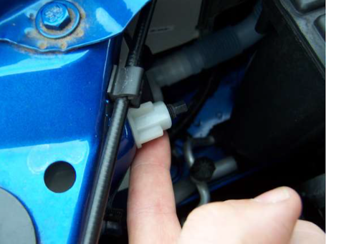

Working under the bonnet, remove the white retaining nut at the back of the headlight unit by unscrewing completely off. Exactly the same on both sides.

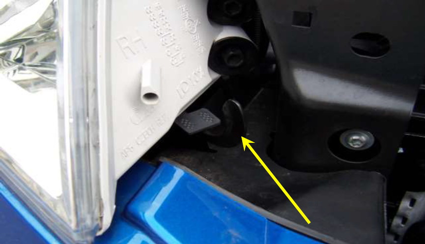

Pull on black hook in direction of opposite headlight. It may be stiff so pull firmly but evenly again do the same on both sides of car.
Step 3 -
The headlight unit will now move forwards slightly. Pull headlight unit forwards and carefully tilt over and remove electric connector.

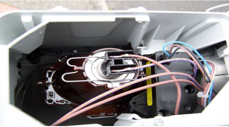

Remove Plastic backing to gain access to headlight unit by pulling metal clips outwards. Then remove headlight bulb connector by pulling upwards and headlight bulb by pushing metal connector to side then lifting up and removing bulb. Do not touch the bulb glass.
Step 5 -
Now as indicated in the picture there is a small metal bar that slides up to convert the light beam pattern.

To move the metal bar I will describe the drivers side first as this is the hardest to do and you require a small screwdiver that is quite long.
Step 8 -
There is a small black plastic lever on a spring indicated by the arrow in the picture. Push down with the screwdriver on this lever and then turn the screwdriver clockwise, there is only a small amount of movement required so watch the bar as you turn. Once the bar is level as shown in picture above then replace the bulb and connector etc and refit the headlamp.
You now need to do the same on the passenger side
Picture showing the black lever on passenger side. On drivers side it is behind the electric connector block that is inside headlight unit.
Another picture of metal bar in correct position. Ensure the bar is level with rest of metal reflector or the light pattern will be distorted.
