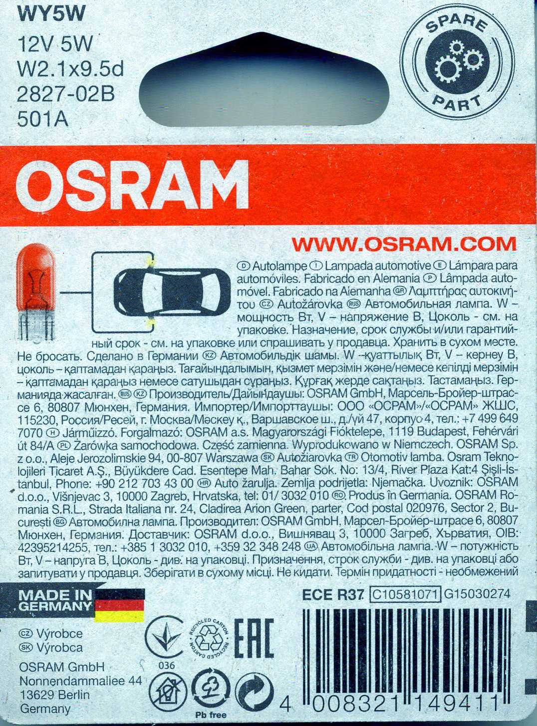

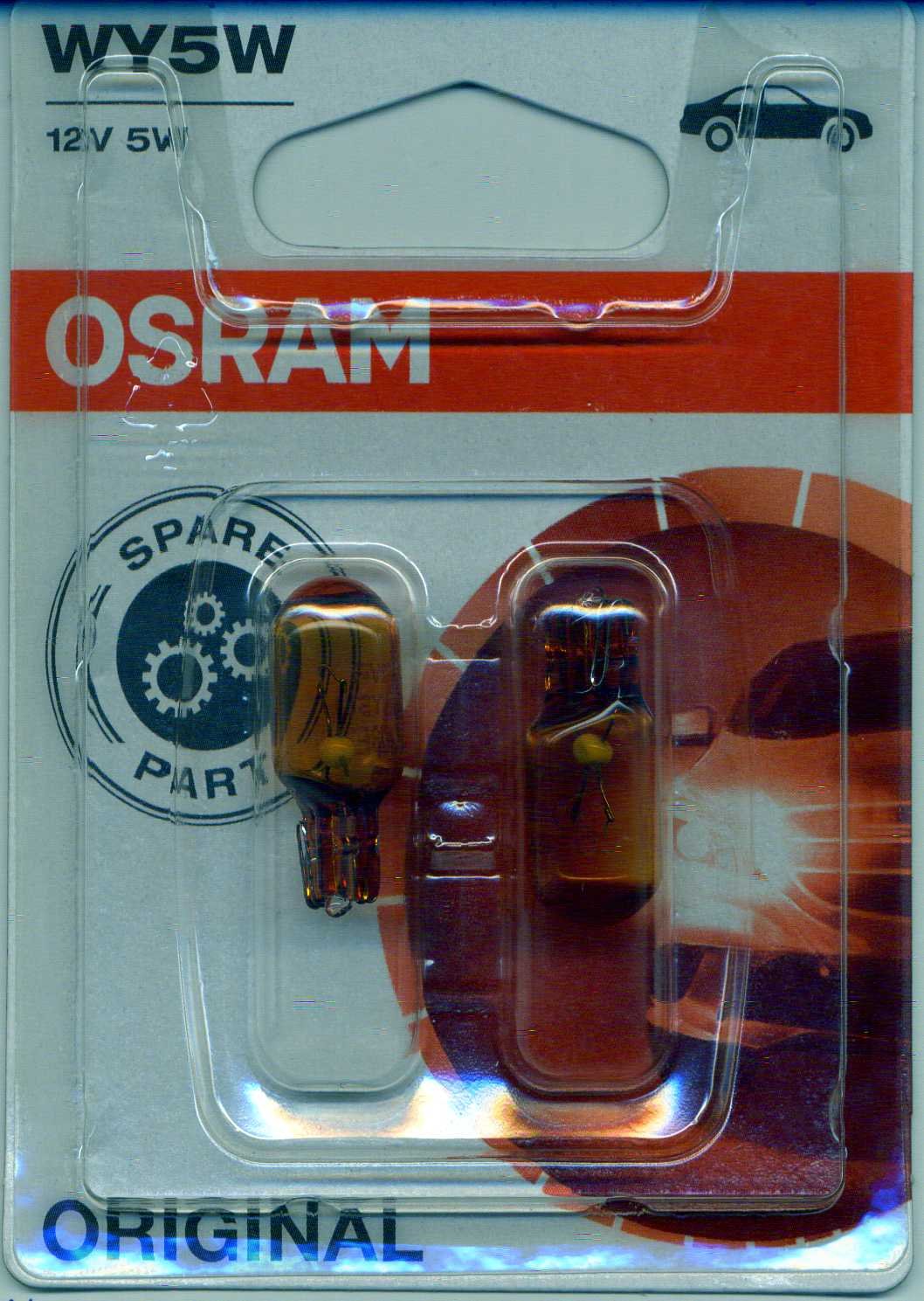

Hi!  I know it's a few years down the line since the above posts but I've just followed vc-10 and wirer's (thank you guys!) very helpful guide on changing the bulbs on the Skoda Rapid's side indicator repeater lamps in the door mirrors.
The bulb stated by Saffron Skoda above is a WY5W for the Repeater but does this signify that it's an orange bulb?
Basically, because Halfords said they didn't stock them, I ordered the bulbs from Amazon Prime UK on Bank Holiday Monday at 5.41pm (they arrived this morning) but before I pull a friend's Rapid door mirror apart, did I actually order the correct bulbs?  Are they indeed the same ones used in a Fabia Mk 3 as vc-10 asserts?
Thank you.
JimmyR
https://www.briskoda.net/forums/topic/453915-fabia-mk3-side-repeater-bulb-change/
Rapid side repeater bulb change
By vc-10, 9 August, 2018 in Skoda Rapid Guides
Just a quick note to say that the bulbs were indeed the correct ones and the replacement was much easier than anticipated because it only took a couple of minutes.  Thanks again to vc-10 and wirer for making it so simple for me. 😀
