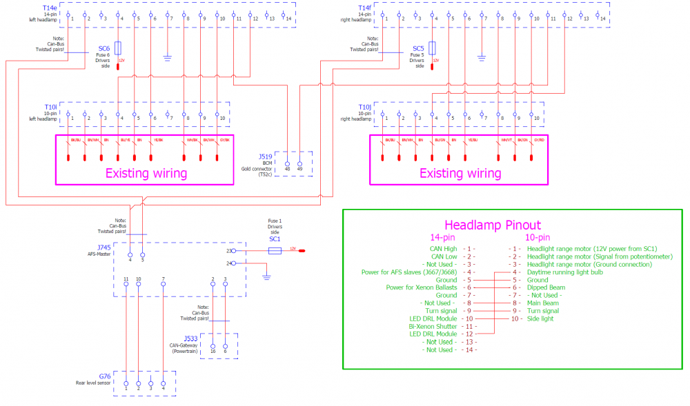

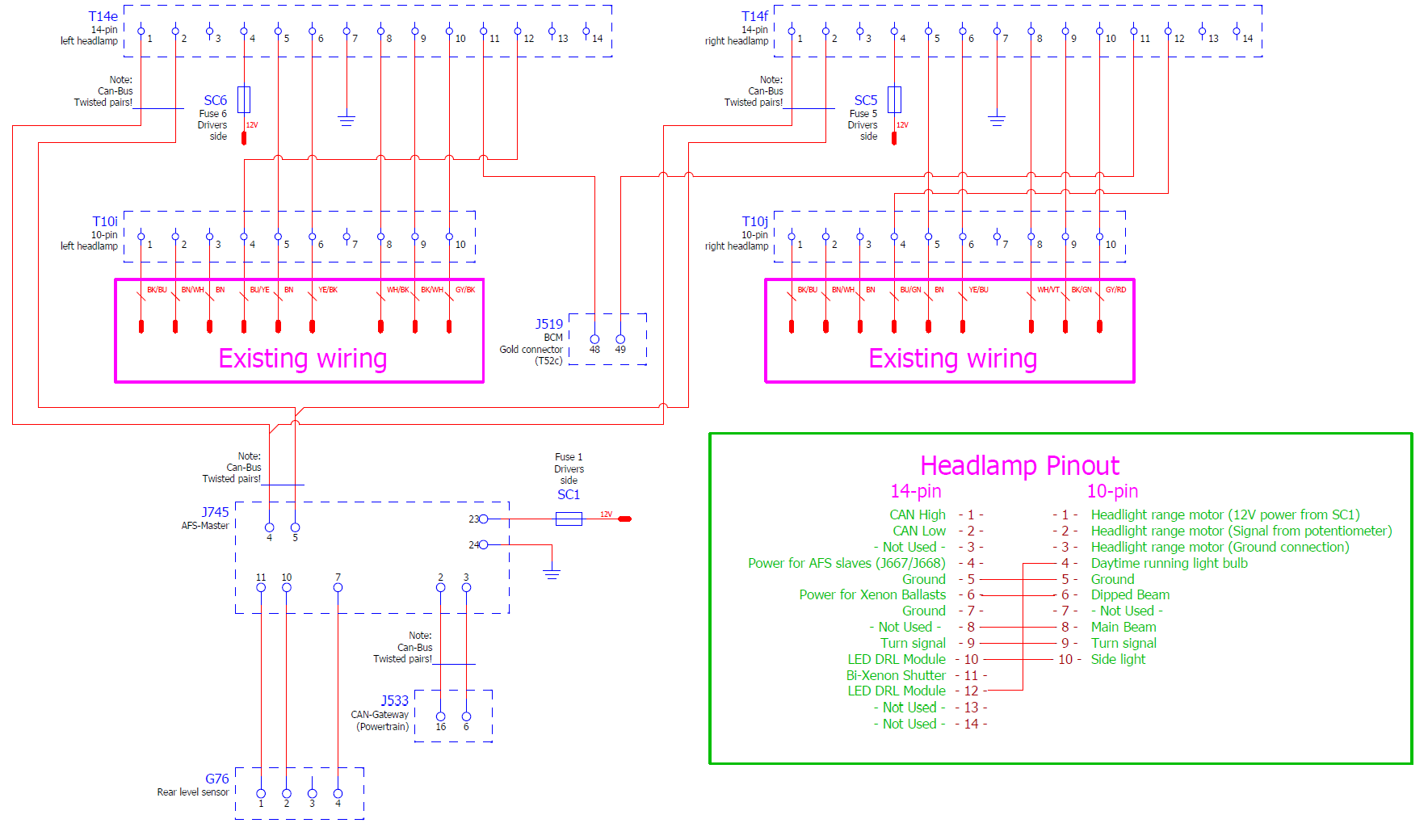

I grabbed a wiring kit for a MK6 Golf from aliexpress as it was the cheapest way to get all the connectors. I did modify the adaptors to fit the Octavia wiring as the pinout was different to the MK6 Golf. You'll need to check the wiring diagrams for the MK3 with and without xenons to be sure of what changes are needed.

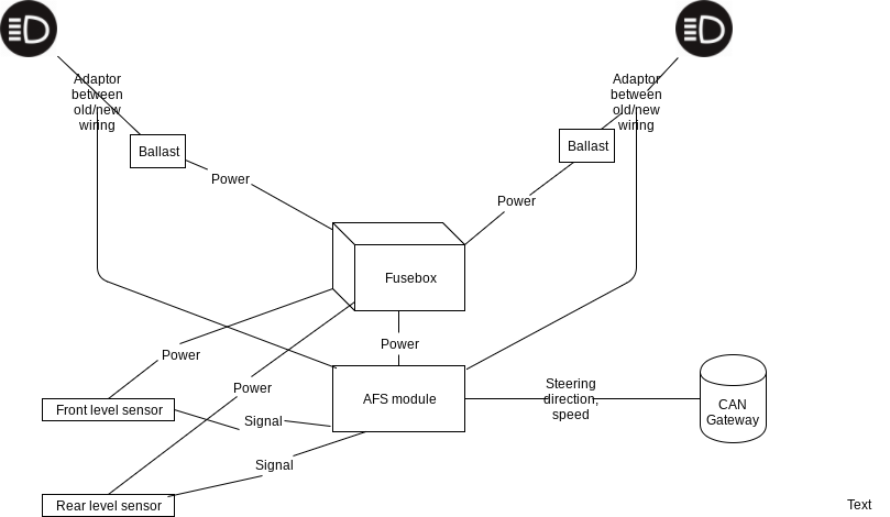

Assuming you skip the levelling, the adaptors can probably be fitted between the existing headlight connectors and the headlights although you'll need to double check if the LED modules need any extra connections.
In my case, I added the following extra wiring:
- adaptor between existing headlight wiring to new headlights as the connectors were different
- each headlight to the AFS module (CAN high and CAN low)
- each headlight to the fusebox (power for xenon control module)
- front level sensor to the AFS module (power, ground, signal)
- rear level sensor to the AFS module (power, ground, signal)
- AFS module to CAN gateway (CAN high and CAN low)
- AFS module to fusebox (power/ground)
It might be worth reading this thread about a MK7 Golf xenon retrofit (should be electronically similar to the MK3 Octavia), the pinout might be slightly different for the Octavia headlights:  http://www.golfmk7.com/forums/showthread.php?t=29237
You can also get the wiring diagrams for your car from https://erwin.skoda-auto.cz/erwin/showHome.do

You'll be dazzling other motorists as you'll have no way to adjust the headlights whilst driving.
Without the AFS module and level sensors installed you won't get:
- automatic up/down adjustment - this is to meet ECE regs therefore making it road legal
- manual up/down adjustment -  as the headlight range adjustment on the dashboard will not work
- automatic left/right adjustment - also known as 'bend' lighting or dynamic cornering lights
- AFS driving modes
If you adjust the headlights to the correct MOT height while stationary, you will still dazzle any oncoming motorists when you accelerate or have any weight in the boot.

If you fit the headlight controllers,  AFS module and level sensors, then it will work exactly like a factory install and will not dazzle other road uses when correctly set up. The car will correctly adjust the headlight aim for acceleration and loading the boot.
I was making the point that if you fit the headlights without the headlight controllers, AFS module and level senors, it will cause glare as neither you or the car can adjust the headlight aim.

Inside the headlight there are two motors to move the xenon projector, one for each axis, these are connected to an AFS slave on the headlight body.
The two AFS slaves (one for each headlight) are connected to the AFS master which is normally in the cabin somewhere.
The AFS master is connected to the suspension level sensor(s) and also to the appropriate CAN network to communicate with other modules, for example the steering assist module.
The AFS master takes the data such as speed, steering angle and suspension level to calculate where each headlight should aim. It will send messages to each AFS slave which in turn will move the headlight motors.

I've started a schematic (very basic) of how i expect the wiring to look like.
Looks about what I'd expect apart from the level sensors probably get power from the AFS master.
This is a great schematic for the additional wiring needed on for MK6 Golf with a single level sensor.
It will be different for your car but should give a good idea of what's needed.
