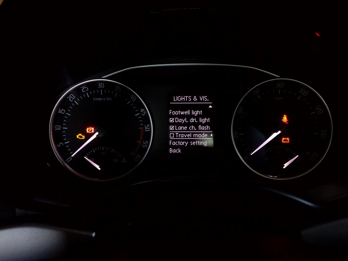

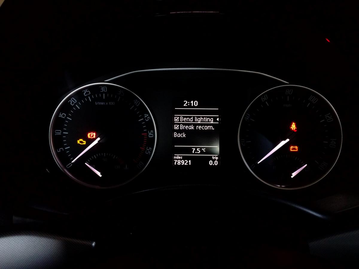

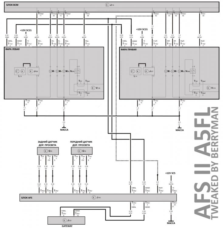

From what I understand, it should also be possible to enable AFSII as the module is running SW:0148. This will change the 'lighting cone' depending on speed and conditions rather than just levelling and bending. I'll add the coding later if I figure it out...
Hi Langers2k,
I have coded my retrofitted Xenons to 1441884 - That gives me "Citylights" and "Motorway Lights"
In city lights, the left cone (I live I europe) turn all the way out to the left in speed between 15ish-40km/h and all of the road is illuminated.
I have tried to make a video of it here
https://youtu.be/Wo6mIZ9nxyQ
I motorway light, the length of the light increases along with speed
Can you tell me how you have coded your bcm?
Since I have retrofittet my xenon, I have lost the DRL's next to the fog lights!
Hi Langers2k,
Nice to see another factory style xenon retrofit :)
Did you get that code from Dmitriy?
I think I know how you lost the DRL, can you tell me what changes you made to the BCM? Even better would be an autoscan from VCDS if you have one!
No, I just stumbled upon this thread in German, and wanted to try it out when I finally got the retrofit done.
http://octavia-rs.com/index.php/thread/21292-1z-fl-afs-erweitern/
Wow, that could be really nice to get them back
I will make a new scan sometime in this weekend

I found a scan, not that old
Perfect, try changing byte 14 in "Address 09: Cent. Elect" from 8B to 91. You might need to do this manually as there won't be a checkbox for byte 14, bit 4.
Currently the car is coded to use pins C48/C49 to control the bi-xenon shutters, the Octavia hasn't got bi-xenon and instead uses these pins for the DRL :)
langers2k, how can I ever thank you?
It worked like a charm, I am one happy camper, thank you!

On 10.03.2016 at 22:48, langers2k said:
... if people are interested I can add a schematic for the loom I ended up fitting but it's basically taken from the factory wiring diagram. I didn't fit the wire shown on the WD between T26e/8 and T52c/52 as other cars with the same AFS controller didn't seem to have it, there are no errors shown and everything works as expected so I've no idea what it's purpose is! I also have an extra wire to each headlight so if I decide to go for a custom bi-xenon set up later I'll be able to control the shutter properly.
I am interested...thx
@gabi2004 - the car in your profile looks like a pre-FL so it's unlikely to share the same parts/wiring as the FL.
Anyway, Berryman posted this on another forum to give a good idea what's needed.
yes it is pre fl with oem xenon...I will change everything...thx for diagram.

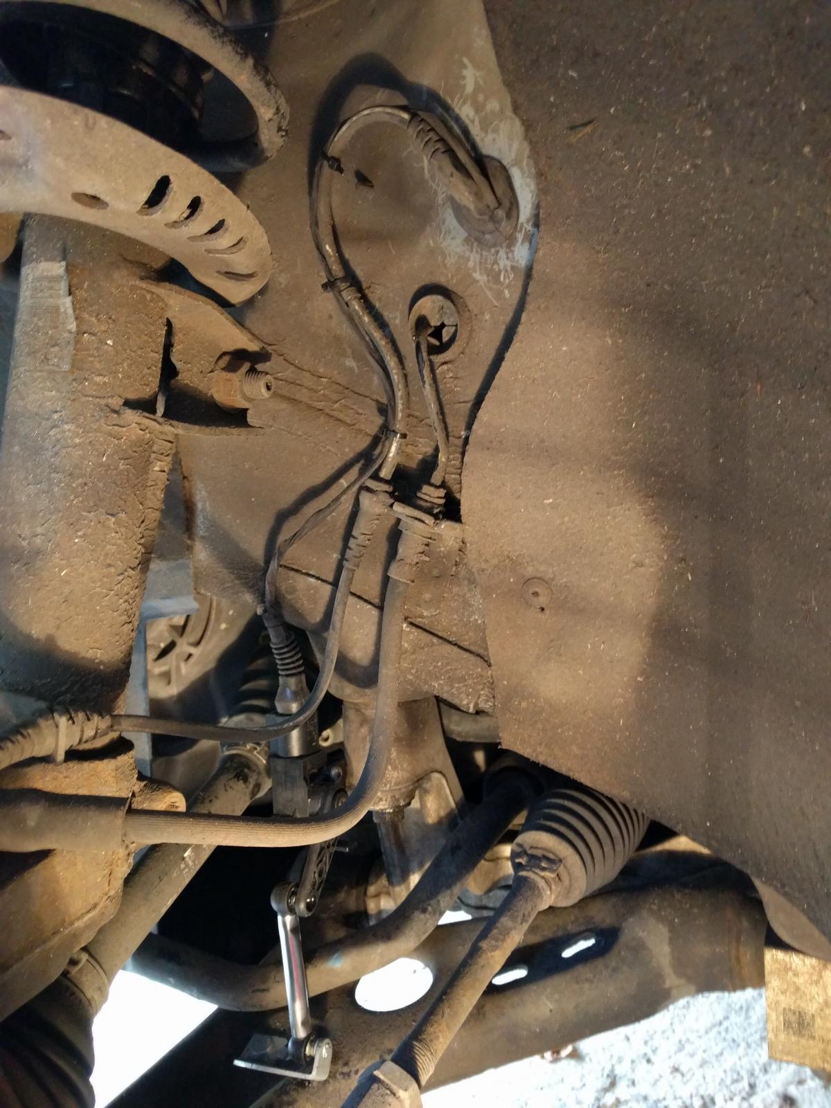

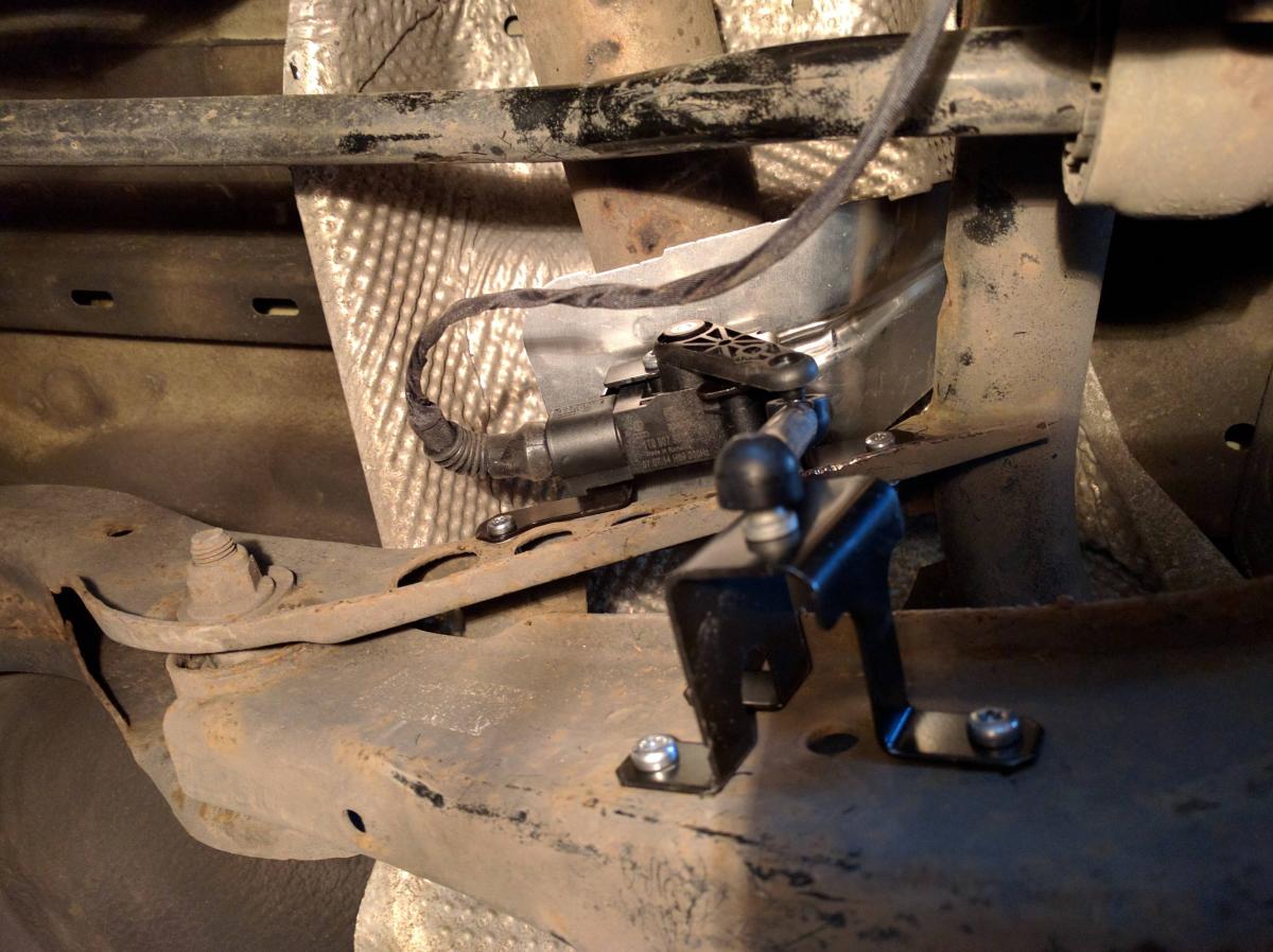

What AFS module did you use? And why did you mount two leveling sensors. I know that after 2008, 5M0 907 357 C AFS modules use only one leveling sensor.
Thank you!
@trflorin - Yes I used a 5M0 907 357 C and it can use either one or two levelling sensors depending on coding.
I fitted both as I wanted it to match factory fitted xenons. If Skoda/VAG thought it could level properly without a front sensor, they wouldn't have fitted one like on some Golf's :)
