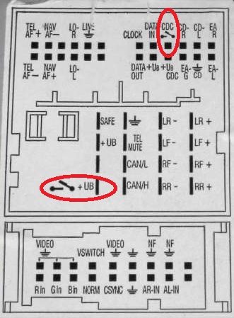

Nexus (MFD2) should have a "switched +UB" output on the back. Also for RNS510 and a lot of other OEM units the "switched CDC" output can be used as a remote.
Ok so should be able to run it from the hu itself?
