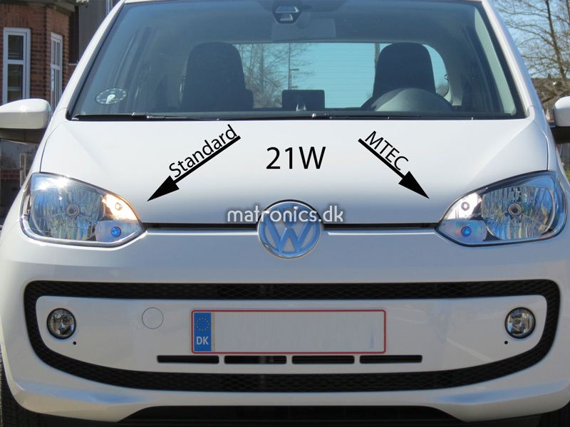

I tried several of those LEDs but found them all to be too dim. They stick out farther than normal and the light is not reflected. These MTEC are brighter and have white light: http://www.ebay.co.uk/itm/MTEC-W21-5w-T20-DUAL-FILAMENT-SIDE-DRL-7443-SUPER-WHITE-HID-EFFECT-BULBS-Pair-/400385373634?pt=UK_CarsParts_Vehicles_CarParts_SM&fits=Model%3ACitigo&hash=item5d38d3f5c2

I ended up with the MTECs. http://www.ebay.co.uk/itm/MTEC-W21-5w-T20-DUAL-FILAMENT-SIDE-DRL-7443-SUPER-WHITE-HID-EFFECT-BULBS-Pair-/400385373634?pt=UK_CarsParts_Vehicles_CarParts_SM&fits=Model%3ACitigo&hash=item5d38d3f5c2
They are more blueish than the Osram Nightbreaker Plus H4 and HB4 that I use for main lights and fog lights...

It's not easy to take photos that are comparable - but here's some that show the standard DRLs vs. MTECs. It's easy to see that the MTECs are whiter.
