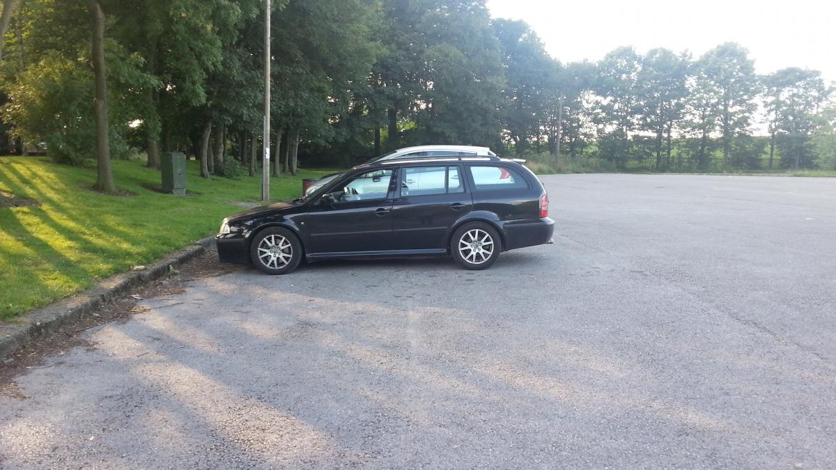

Does anyone know what the stock vRS ride height is suppost to be?
And also what are peoples opinions on how much to lower it by?
Ive just put some weitecs on to replace the **** racelands (which turned out to be racelands on the front, and FK dampers on the back bizzarely the weitec dampers have less travel then the FK dampers.)
Apart from some minor left-right adjustments im not sure what to set the ride height to in relation to front-rear. As an example the attached pic is with the rears at the top of their adjustment.

what weitecs have you gone for? as i have hicon gt's and mine have loads to go and it's sat at this height.

my front can go own good 3 1/2 inches still on that.

Jus whack the back down level with the frontband see how you feel mate :D
Looks ok to me just needs some 17in spiders on it now

if you slam it you will need to sort the front drop links out as they are not right length and drive shaft hits the rollbar.go for about 35-40 mm less than standard and have slight more drop say 10mm on the front to help keep weight on front of car to help stop understeer.dont go mad though.all this dump it on the floor is daft if you want to drive it day to day in comfort.have set up cars for tarmac rallying,sprints and trackdays for years now and on the floor is a show thing not a nice quick daily driver.

Your pic is a good height and balance between front and rear, always best to have front slightly nose down. I have had Weitec GT's and went very low and the ride was not that good, I now have KW and car is a lot lower than yours. so maybe a tad lower with your weitecs if you want  but your looks good to me.
Not true,  VRS do not have the std VW golf  ARB bar set up that is a hooped bar over drive shaft. VRS has the same as Audi TT,S3, Golf R32 with Drop links attached from FARB to Strut and not wishbone to ARB  , no clearance issues or hitting with the VRS set up with Weitecs..

Then someone has changed yours, No VRS was sold with a STD skoda octavia or VW Golf ARB set up.
Think you need to rephrase "Normal Skoda set up" as "normal Skoda set up" is like saying normal VW Golf set up. The VRS is not normal Skoda set up it is unique as per above statement buddy :thumbup:
