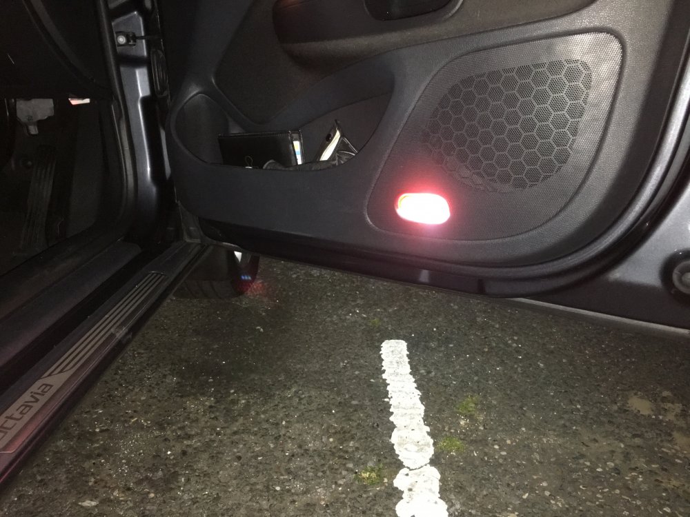

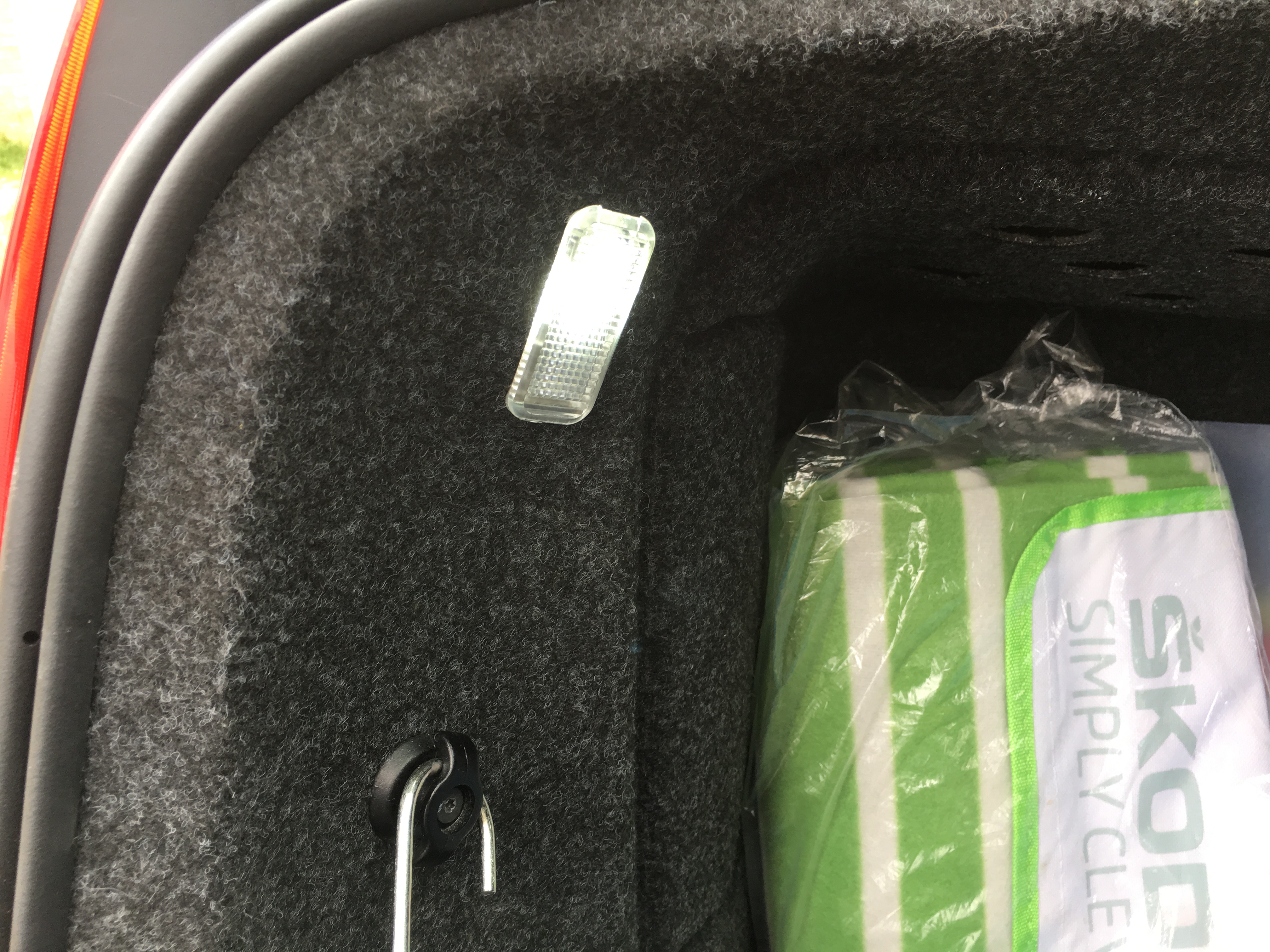

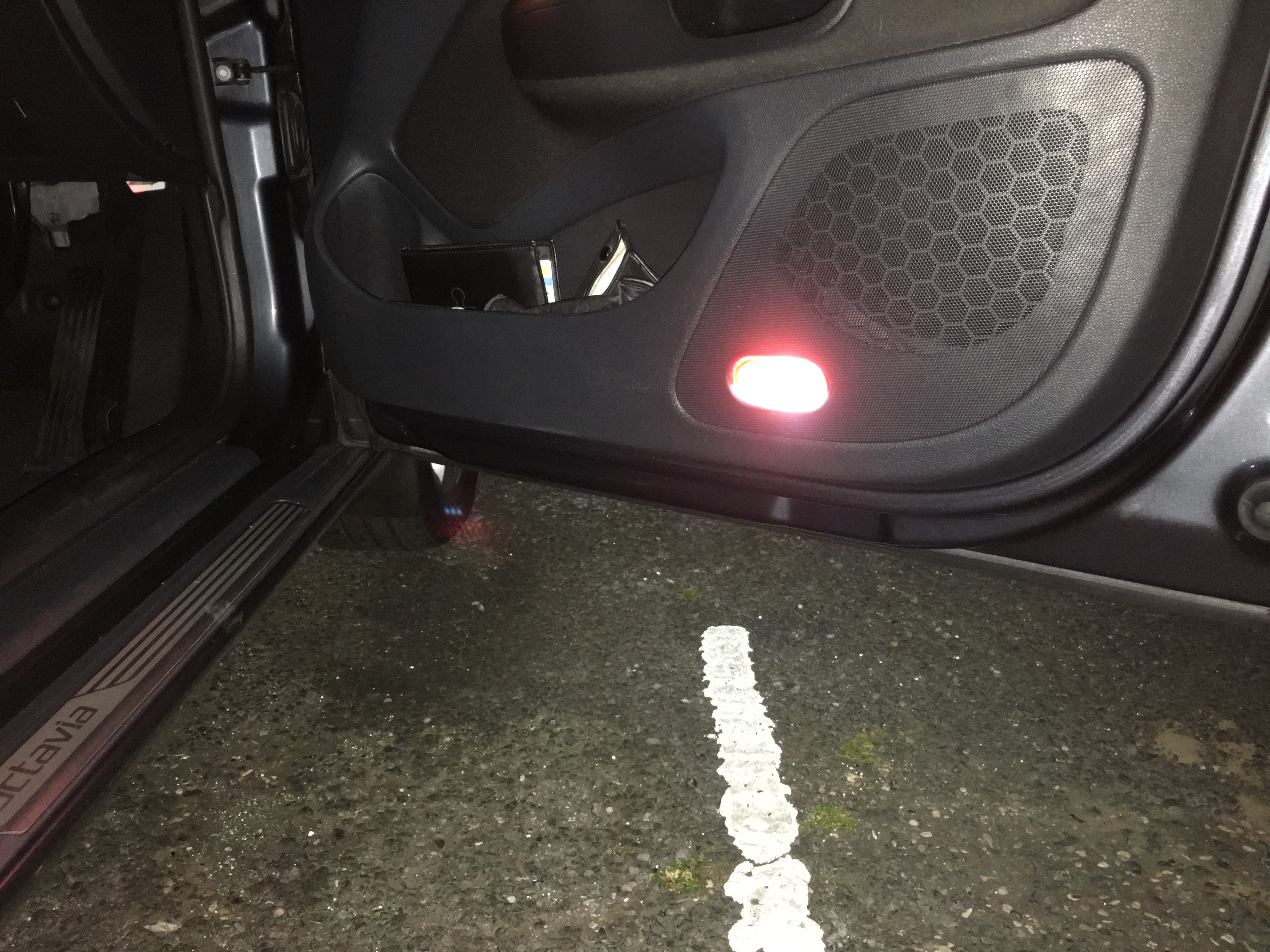

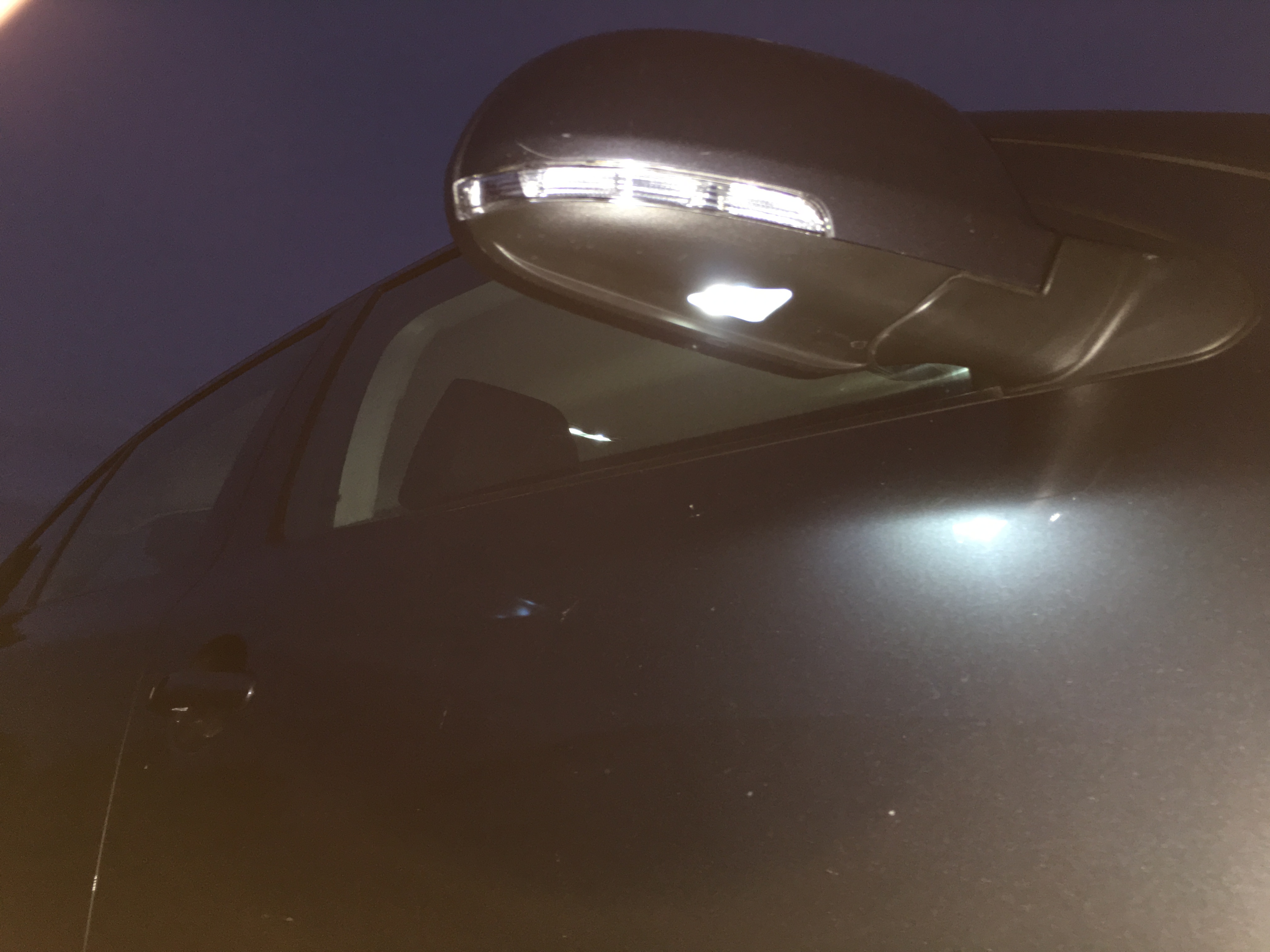

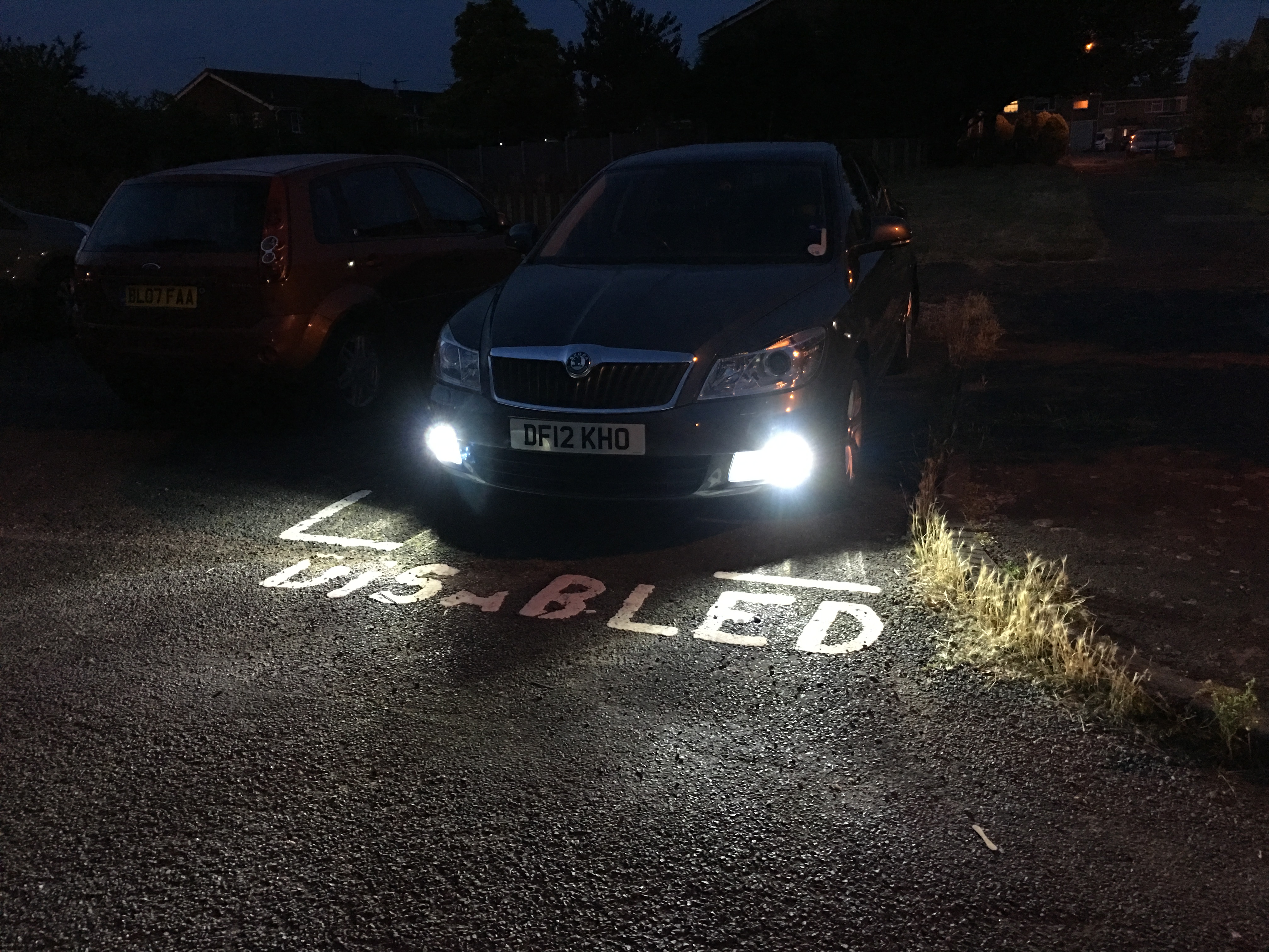

I have started doing my MY12 Octavia Elegance GSG7.   I have posted some pictures.     So far, DRL's with resistors, Fog/Turning lights with resistor packs.   Side lights on front and small w4w lights on back do not need resistors.   Door lights and Puddle lights again, don't need resistors, but if you scan with VCDS you will see a fault thrown up, but nothing on the dashboard.
All interior lights have been changed to LED as well, including the boot lights.  Looks so much whiter and brighter inside the car and in the boot.  Just straight forward swap for equivalent sized LED.     Number plate lights are LED,  with warning turned off in VCDS or you can buy Canbus friendly ones now.   Reversing lights are done with resistors.
NOTE:-   all of the resistors are temporary untill I am able to go and see langers2k who has offered me help, to have the BCM coded with some Professional kit he has, to stop all warnings.
Stop/Tail and Side/Fog lights will have to be fitted with resistors temporarily.     Indicators will go to LED within the next couple of weeks, however, if I get "HYPERFLASH" or anything silly, then I fear that resistors may be the only way, unless I can find bulbs with built in ballast.
Please look at my album to get an idea of how it looks so far.
Some pix below.
