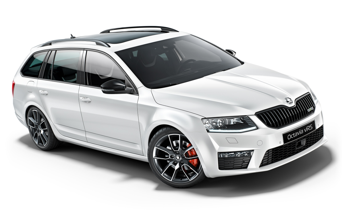

I have a Vrs on order however have noticed that the photos provided by skoda before launch all show the vrs to be sitting slightly lower which is a look I prefer.
Has anyone else noticed this or agree and know of a set of springs suitable?
Not looking for stupid low, just enough to allow 18" wheels to fill arches a bit better like the pics of the one in white attached.

Ive got a mate who works in the industry and apparently they fill the engine bay and boot with sand bags before they shoot them!
