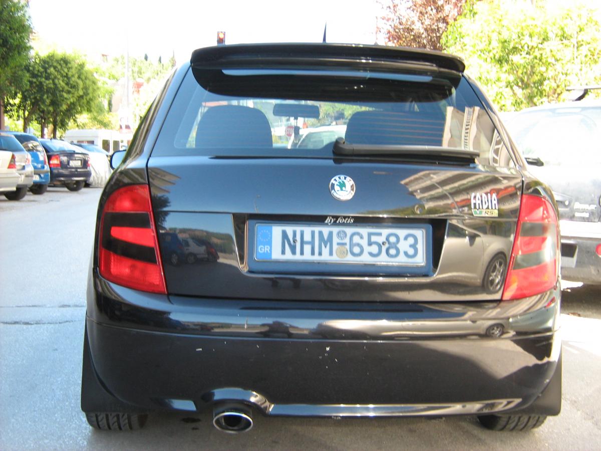

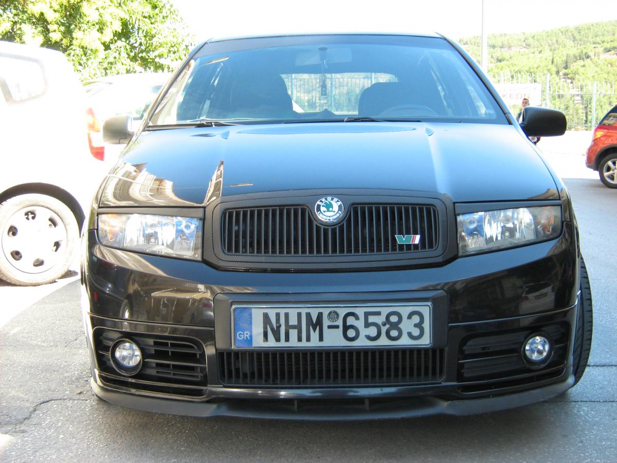

here is mine at Ta technix coils .in front the lower terminated and i need more.what can i do?
Take the helpers out on the front and cut the bump stop down a little bit and remove the adjusters on the back
