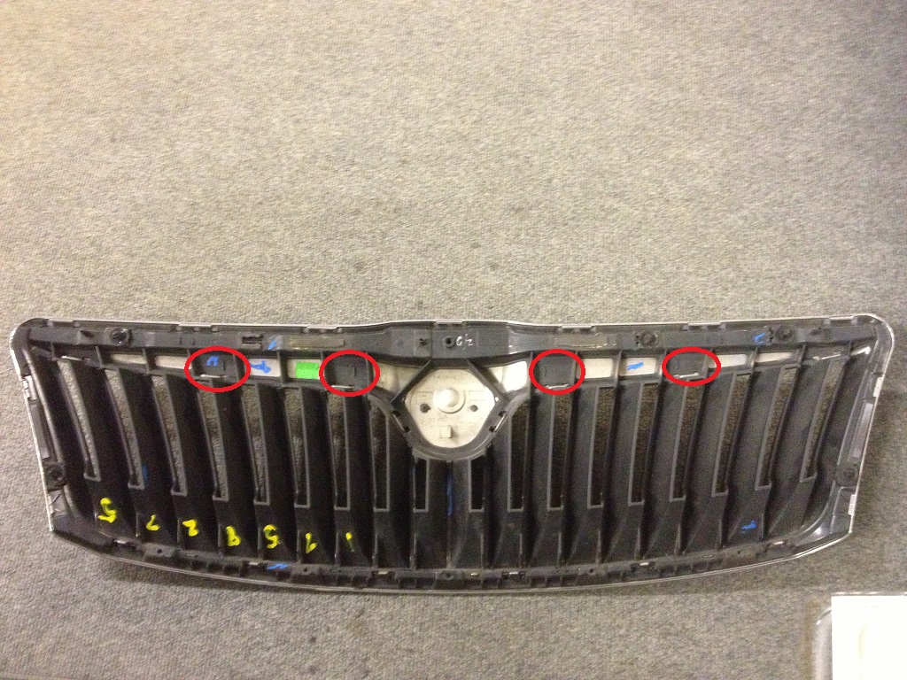

I'm sure someone has successfully separated the chrome outer from the black inner on a FL grille..... but for the love of god how!?
I tried and failed. Got mad. Put it back together before i broke something!
Anyway I heated the clips up so i didn't snap them and got them all undone. However it still wouldn't come apart. Is there glue or adhesive under the bits I've circled??

I did it when I plastidip coated mine and changed the badge to the silver one.  I can't recall it being that difficult - there certainly weren't any hidden clips.  I have a vague recollection that there may have been some glue or tape behind the chrome though.
If its the same as the pre-FL (which I'm sure it will be), push a small socket bit over the prongs to release them. Work your way around undoing them all. There'll be some tape/glue along the bottom edge which should easily peel off.
Brute force, 2 people, a pic, a screwdriver and lots of pinched fingers lol
It comes apart eventually but take your time and persist with it.
Finally got it!
Hair dryer
Some slivers of old credit card to wedge into the clips
2 screwdrivers
Patience
More patience
Swearing
Now I've just got to vinyl wrap the chrome!
