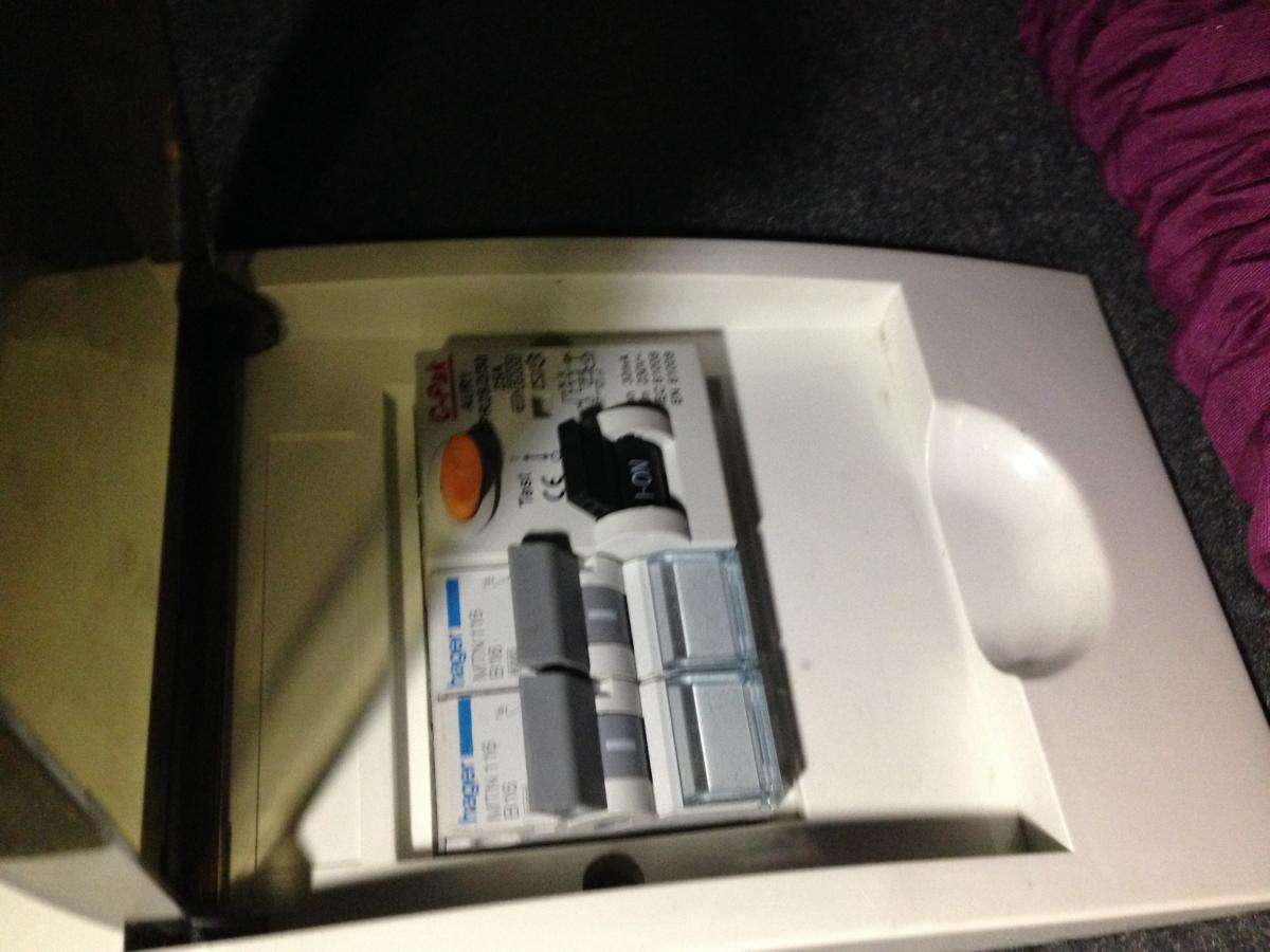

This is the circuit breaker box.
Sockets are split over two breakers and everything has been fine for over a year.
In such short runs those 16 amp breakers will be fine with 2.5mm flex, good to know it has an RCD too. I would think in this day and age it would be part of the regulations to have each supply RCD protected at the outlet anyway but I'm only guessing

Yes but an RCD and a breaker are two different devices. The breaker essentially protects the cabling under fault current and an RCD will help save your life if there is any current leakage. If there is no RCD on the outlet and somebody has a camper without one fitted then its not very safe by todays standards  :D

Oh dear lord, there are enough RCDs, breakers, fuses, bits of wire, switches and plugs all stamped by a qualified sparky so don't worry.

There might be in your camper, but do you think everybody has one. I don't think so.

All of the sites we used to visit for both our camping holidays and caravan holidays had both Rcd's and breakers on the supply bollard on the site. This is just one of the clubs site bumph leaflets just to use as an example - http://campingandcaravanningclub.co.uk/helpandadvice/technicalhelp/power/electricity-for-campers-and-caravanners/
