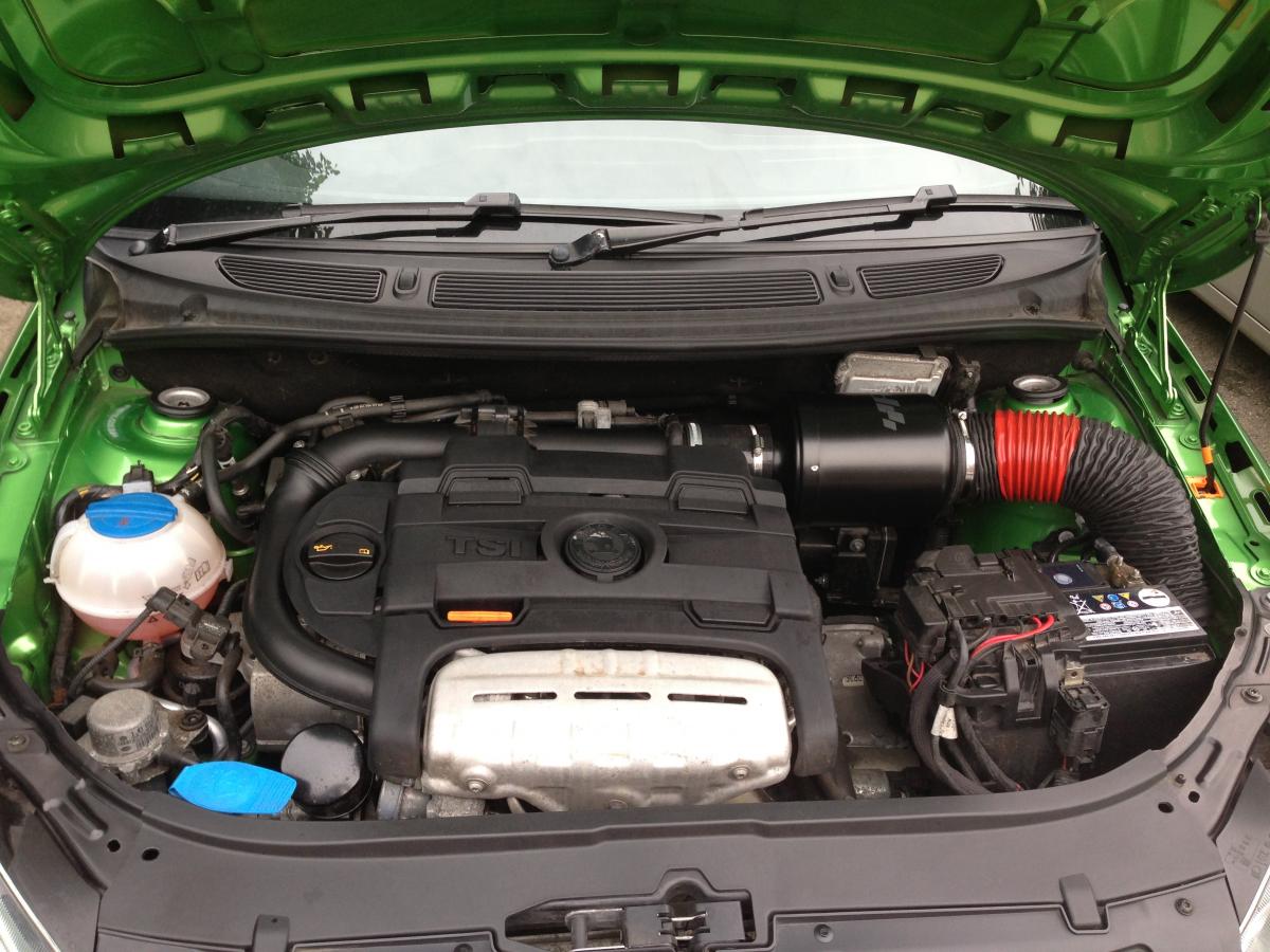

Standard car for comparison...
Yo Ozfabia is ur car lowered , from ur foto i cant see if there is a gap at the top of your struts or not because the plastic cap at the top is a lot more curved than mine and from the angle of the foto i cant make out the size of the gap if any.
I'm guessing not lowered
'Is it Normal for a lowered Fabia MK2 ?'
It is normal for a Fabia MK 2 on Standard Height Springs!
(Sparkly, maybe put the plastic caps back on if you have them)
Yep, not lowered.
So your standard vRS top mounts look the same as the lowered ones?!  I'd swear in stock form the rubber rings were in contact with the metal base but then again it's more than a year that I've changed springs, maybe I'm beginning to imagine things... If standard cars are like that then nothing to worry about I guess!
