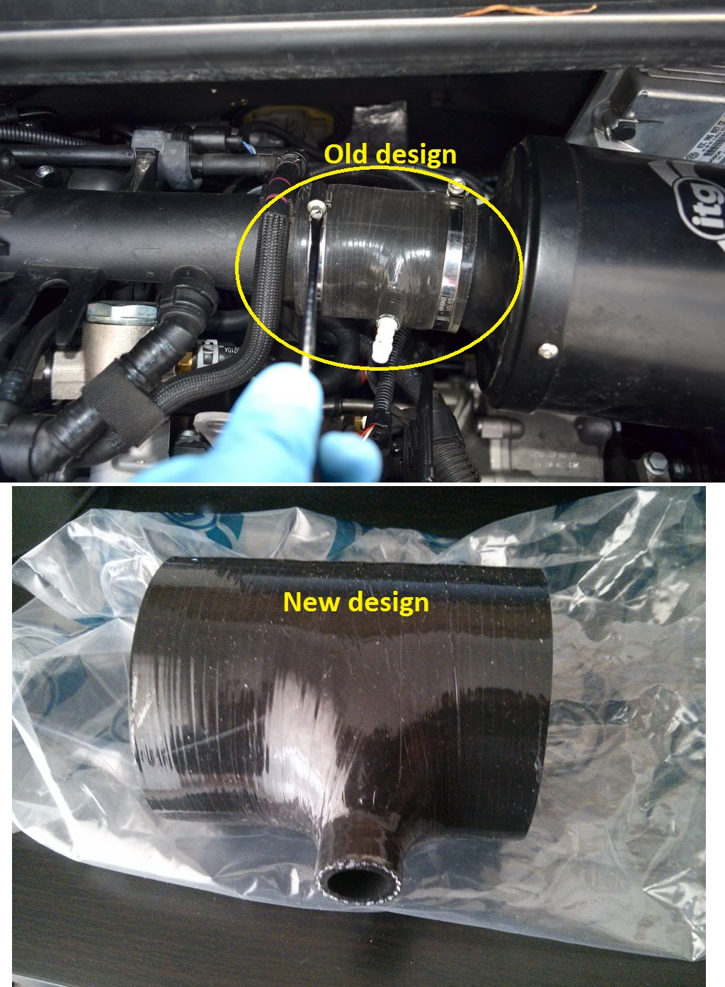

On Friday I received my ITG kit and upon inspection of the parts, I found there was a difference on the small (silicon?) tube that connects on the outlet of the filter-box and has a hole to connect the breather pipe on to it, with respect to what was shown and described in VRS-Powered's excellent DIY guide (see attached photos). As you can see there was no adapter to connect the breather pipe to so I had to contact ITG and ask what was the case. As they quickly confirmed the design has been changed from what it was on 2012. The small white adapter has been removed, the hole is now bigger and the breather pipe is foreseen to be pushed directly into the tube's hole. Anyone installing a recent kit, no need to worry about something missing as I did!  :giggle:

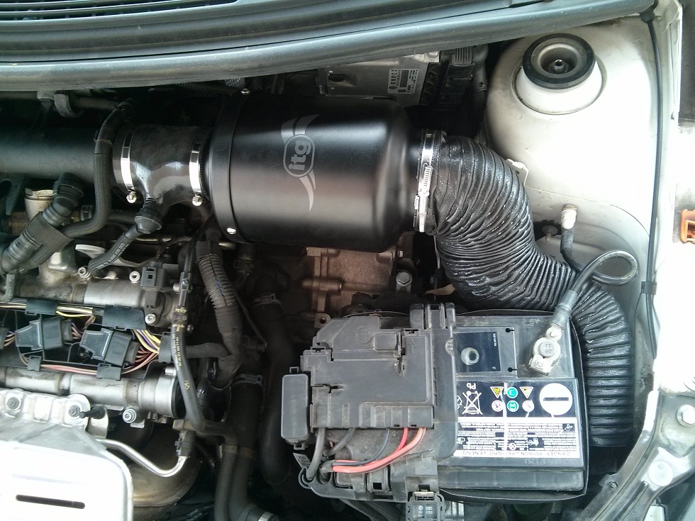

The installation was almost as easy as described in the DIY guide, took me 30 minutes in a rather slow pace. Off then to test what changed...
In revving the engine while stationary (DSG in N) I could hardly tell any difference either from the inside or outside of the car but... when the car started going that was a completely different story! The supercharger sounds really woken up, burying the pedal around 1500-2000 rpm sends a real whine/scream out, much much more pronounced than before and the "woosh" relief when the turbo takes over is also louder. Had some fear that it would be too... "chav-ish" but it is so amusing that since yesterday I am constantly driving in D in order to be in a high gear and then just briefly push hard the gas pedal only to hear this again and again...  :rofl:

1) In turning the engine on, there is I think a knocking sound which is heard once every time I start the car but only then. That was certainly not heard before and I think the ITG is touching some fluid cap which is located exactly below it as I noticed during installation.
2) Up to 2000 rpm everything is as before but at 2400 rpm I feel a clear "vibration" on the gas pedal which was not there before upgrading. It's as the "vibration" you normally feel on the gas pedal at higher rpm (say 5000) but it now kicks in at 2400 and quite abruptly I would say. I was worried at the beginning but then I thought 2400 rpm is where the SC starts working so maybe the new induction is making it work harder?? But is it in a good way or a bad one? That I can't tell. Obviously without dyno figures everything is subjective but I don't feel the car any slower than before so probably nothing wrong i think.

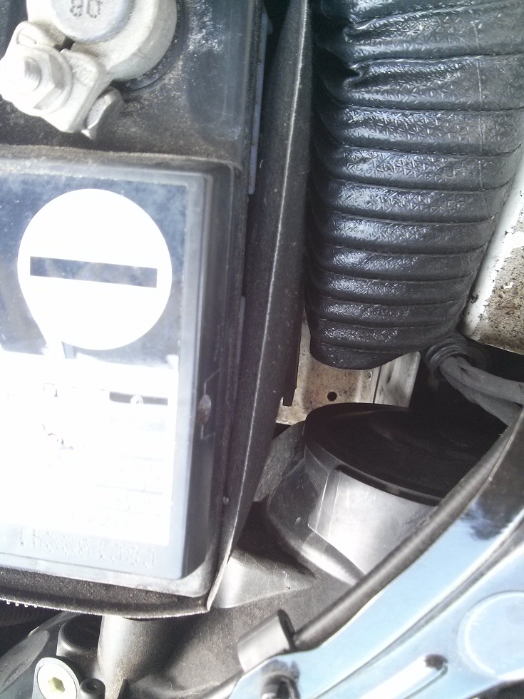

3) Intake pipe's placement. Following other installations I have placed the pipe exactly behind the left headlight at a 45 degree looking downwards. It's only 2-3 centimetres away from the headlight's rubber cap I know but there is where I saw it installed on other cars as well so I thought I'd do the same.
What do other people with ITG think on the above? Have they experienced the same before and after differences and what about my pipe's placement with respect to theirs?

Your new silicon tube looks like mine, which is old.

I have my intake pipe a little further from the headlamp than that, the space you feed into is all apparently a high pressure zone of air, so I figured make use of all of it.

I know what you're saying about noticing new things that were already there but the gas pedal's vibration at 2400 rpm is very clear and surely a new one. Now, the good explanation would be, as you said , that the ITG allows for more air in  and SC is giving a little more. The bad one would be I guess that I placed the intake pipe so close to the headlamp that I am actually reducing the flow and the Supercharger struggles to receive the necessary amount of air when it kicks in, hence the noise at exactly that point. No scientific evidence to choose either version though. I will try to move back the intake pipe by a few cm's and do another test-drive. Also things will be clearer when I do the dyno run before the remap. You would expect a stock vRS with a (correctly installed) ITG to give a little more than 180 bhp...

My installation and kit is the exact same as yours, although mine has a jubilee clip on the little air flow sensor section on the rubber pipping to secure it.

Hmm, maybe I should do a swap with the stock induction to make sure all the things I noticed come indeed from the new kit and weren't there in the first place.
I was just out placing the intake pipe over the battery terminals looking straight down to see if that makes any difference, but it only made the vibration/droning stronger I think so back below the terminals it was. Oh, and trying to get it back between the battery it seems I broke a clip that held some wiring loom to the chassis!  :wall:   Did I mention how easy the installation was? Guess I should take that back...
