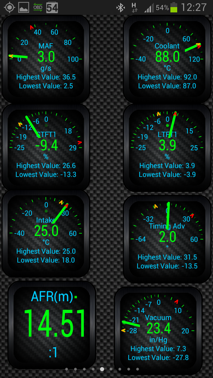

post-8833-0-06032300-1380824441_thumb.pn
Your after something like this

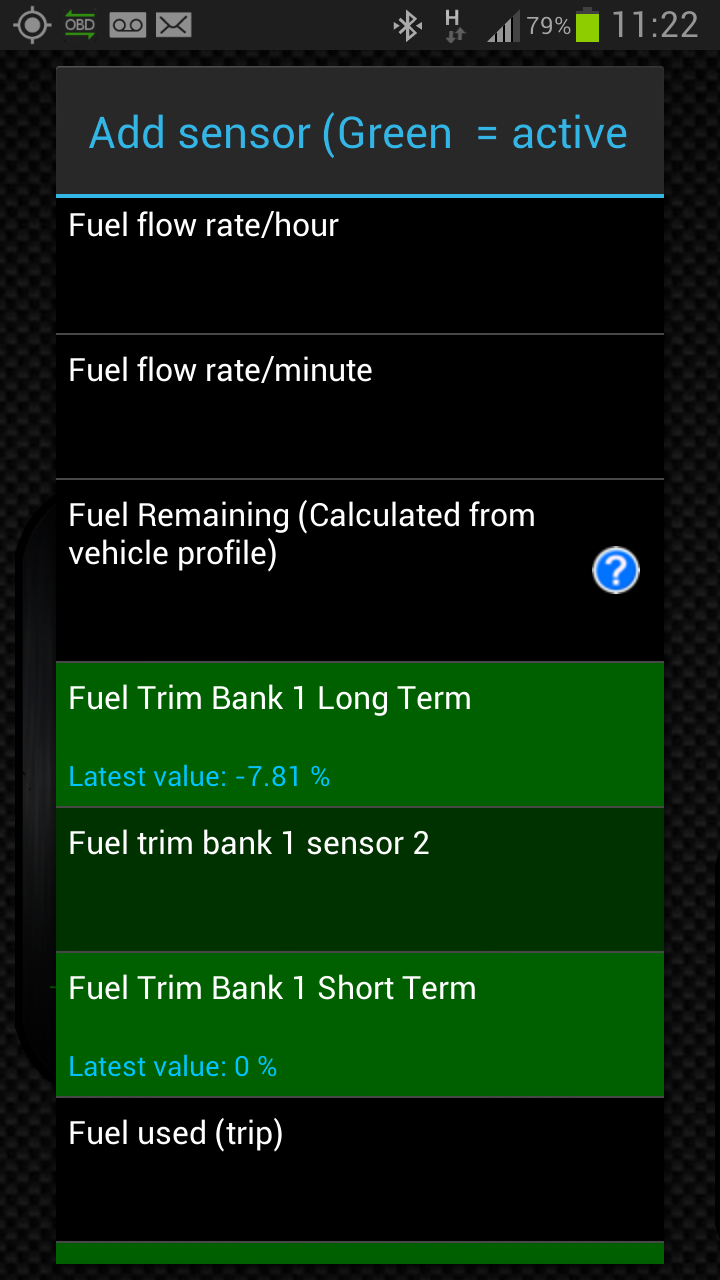

I think I got why you can't get it.
Did you you try an add that dial with the app connected and engine running ??
If not then you need to, I'm not entirely sure what the sensor one does but the fuel trim is calculated by the ecu rather than run of a specific sensor
LTFT is a good indicator of whats happening under the bonnet.
Its the two in green which as said will only appear in the list when the car is running or maybe ignition on will do post-8833-0-66157000-1380906682_thumb.pn
Been trying to upload that picture all day for you  lol
