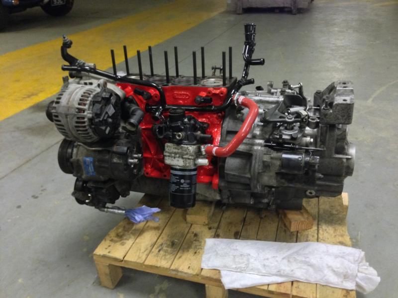

Sump on and sealed
ARP head stud kit in
Any body with experience with this head stud kit know if you gotta re-torque the nuts after a couple hundred miles?

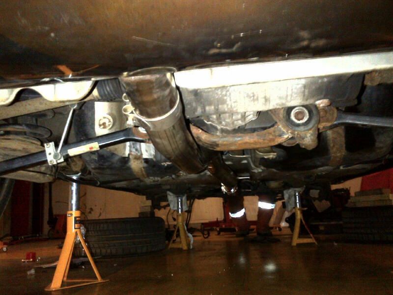

Pipewerx 3" down pipe and sports cat, going Hybrid as where moving in dec and can't afford a whole Garrett kit due to solicitor fees and the missus is going mad with the S3 build which I'm really gutted but a hybrid KO4 will get the car close to what I want and maybe in the future I'll go Garrett. Just need the LOBA320 and I'll be happy with that

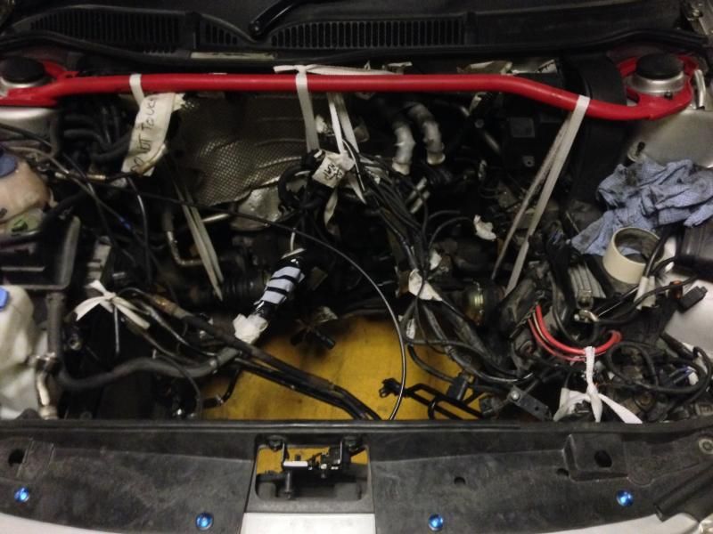

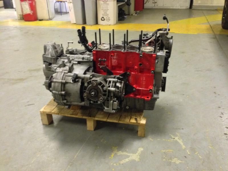

Well today I fitted the new clutch kit and got the gearbox and block mated back together and ran the first bolt in before I released id forgotten to fit the metal gasket between the gearbox and block....Doh!!!
so off it came again and was even harder to put back on as the fecking metal gasket kept coming off and fouling the 2 dowel.
The head is completely remanufactured and for £450 cash if you know what I mean:):)
needed 2 new exhaust valves as they were burnt to feck and. A light skim and it's sparkling so will be fitting tomorrow and hopefully back in the car by sat and start running in.

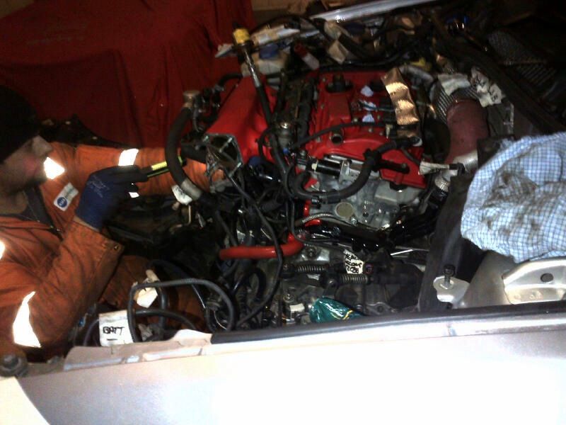

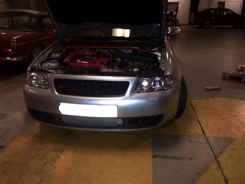

Here`s the rest of the pics from installing the engine back into the S3
And the cheesy grins beginbiggrin.gif It fits....It fits lol
And home in time for tea and medals lol
