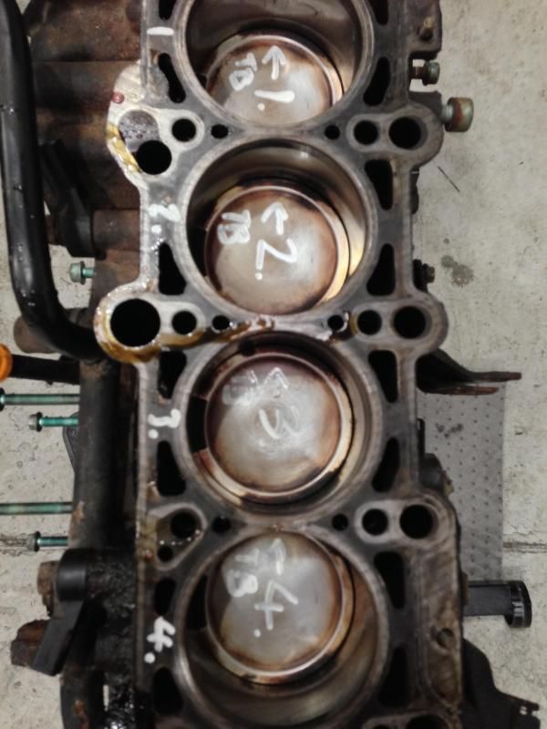

Well today I got the engine pulled, turbo off, manifold off with no seized bolts surprisingly lol, clutch assy off and just about ready for the head to come off and release the surprise in the bores....fingers crossed she's within spec:)

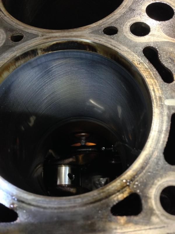

Cylinder one average: 81.111mm with ovality of 0.127mm
Cylinder two average: 81.274mm with ovality of 0.224mm
Cylinder three average: 81.308mm with ovality of 0.246mm
Cylinder four average: 81.260mm with ovality of 0.233mm
Cylinder three looked like it was running hotter than every one else as thats the worst one
But this is with a very good factory cross hatch still shown but its done 115K so some things gotta ware.

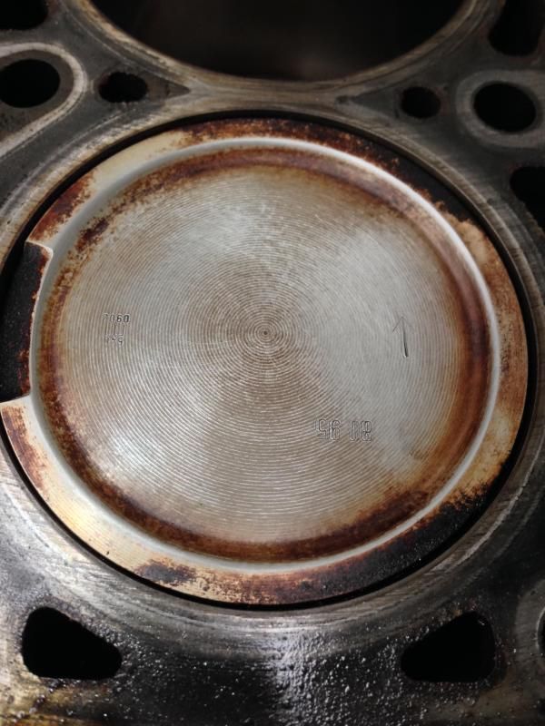

the Oil pump chain tensioner didn't look too bad either, but will be replacing it any way
Shame i gotta replace the pistons as theres not a mark on them
Well today i got my brother who`s a machinist and got him to measure the block, crank, pistons, piston ring grooves and gudgen pins the old fashion way with mic`s and was very happy with the resultsbiggrin.gif
He didn't believe that on of the cylinders was coming back at 81.308mm which should of been slapping like a ******* and smoking oil.
He also doesn`t like the Faro arms as his work just got rid of theirs as it kept giving false readings.
Here`s what we found
so bottom line is every thing is still within spec which is amazing after 115K
