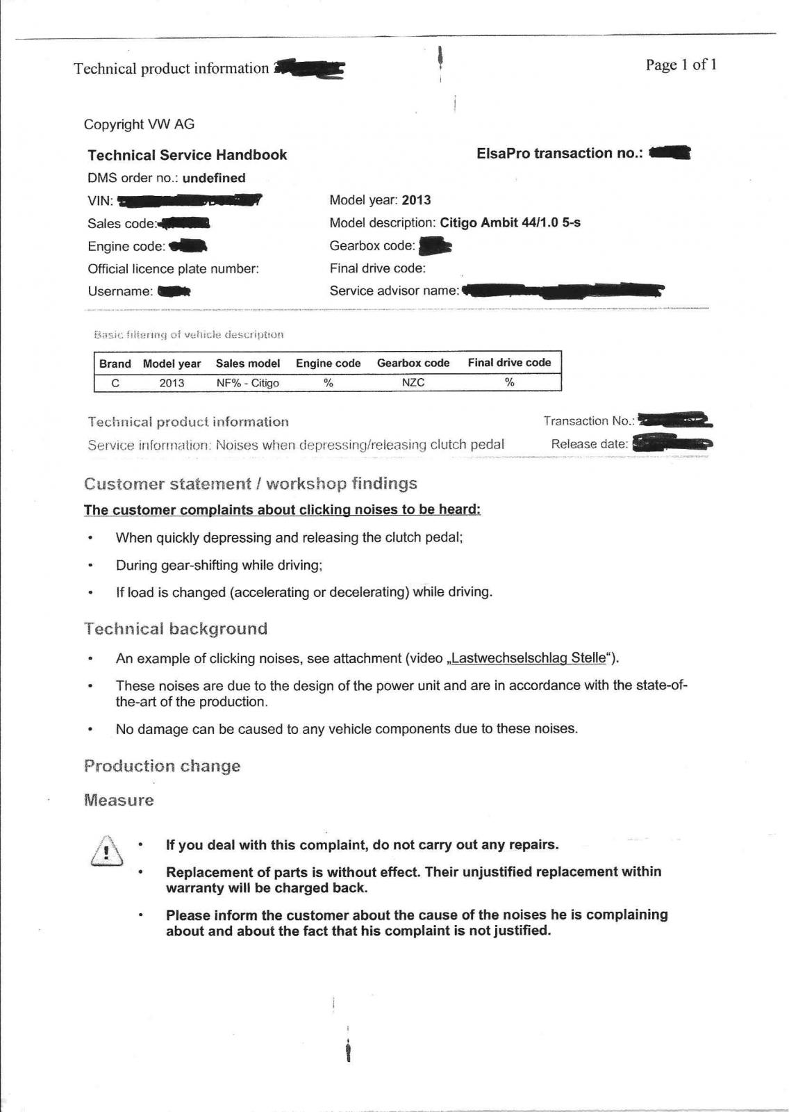

Here is what the bulletin says.
  • If you deal with this complaint, do not carry out any repairs.
  • Replacement of parts is without effect. Their unjustified replacement within warranty will be charged back.
  • Please inform the customer about the cause of the noises he is complaining about and about the fact that his complain is not justified.
So that's Skoda UK's viewpoint, which I will now challenge. I am very disappointed with Skoda UK's could not careless attitude.

And for those of you who think I am delusional and I haven't seen the technical bulletin, I've scanned it in. So if someone can tell me the easiest way to upload the image I will do so.
Re. the above, I looked at this and it struck me that the tone (and spelling) didn't correspond with an apparently official  publication issued by one of Europe's major manufacturers.  But if I'm wrong then I'm sorry for my dubiousness.
I agree that the language and tone of the bulletin is not as would reasonably be expected. Perhaps it came from a very junior source within the organization, and is worth following up.
