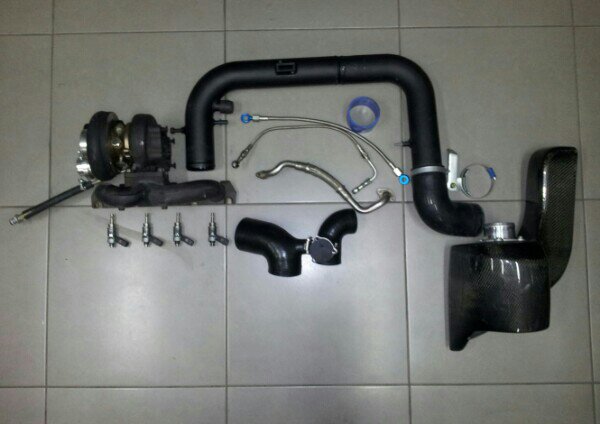

Just got it upgraded a month ago, still tuning it but the aim is in the 500 dynapack whp area, same kit put down 490whp when my friend ran it on his audi.
The only pic I have is of the kit but I'll take some photos soon and post, plan to open a thread about it when I'm done and dynoed
Oooh thats looks nice,......love the carbon look...glad you sorted it as well.

Unfortunately carbon box had to go as it was hitting the water hoses in the front.
Hot a bcs box instead which does the job but doesn't look at nice.
