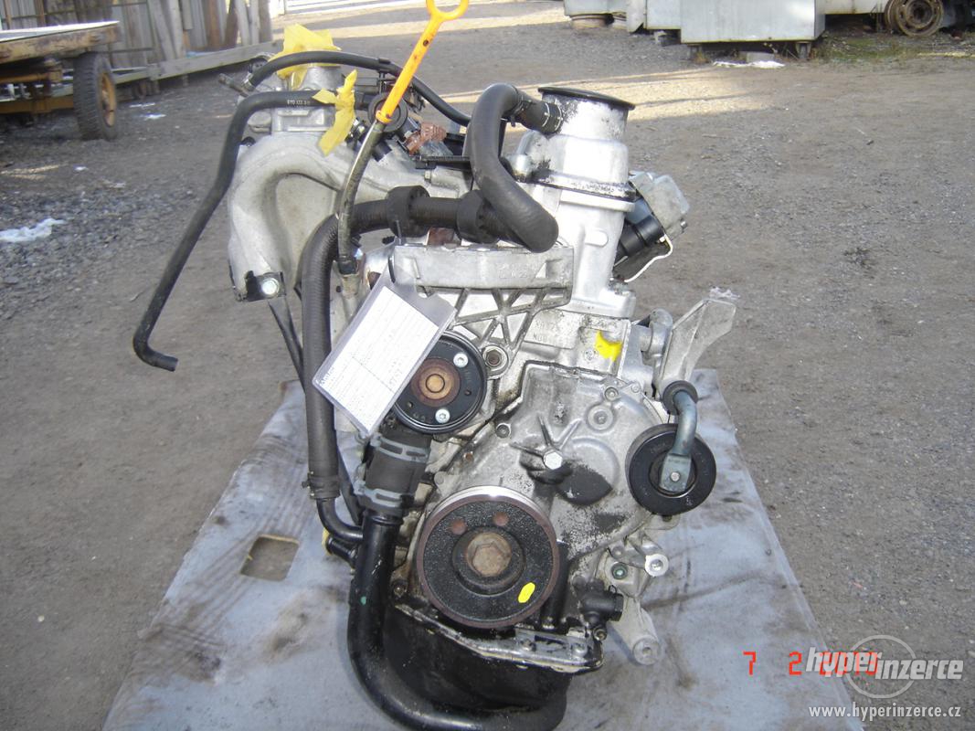

:happy: Engine code on block near water pump. Hard to see, will need cleaning and you may need a magnifying glass if you're long sighted.
See the attached, as highlighted in the picture, that is where to look and see whether it says "136M" or "135".
