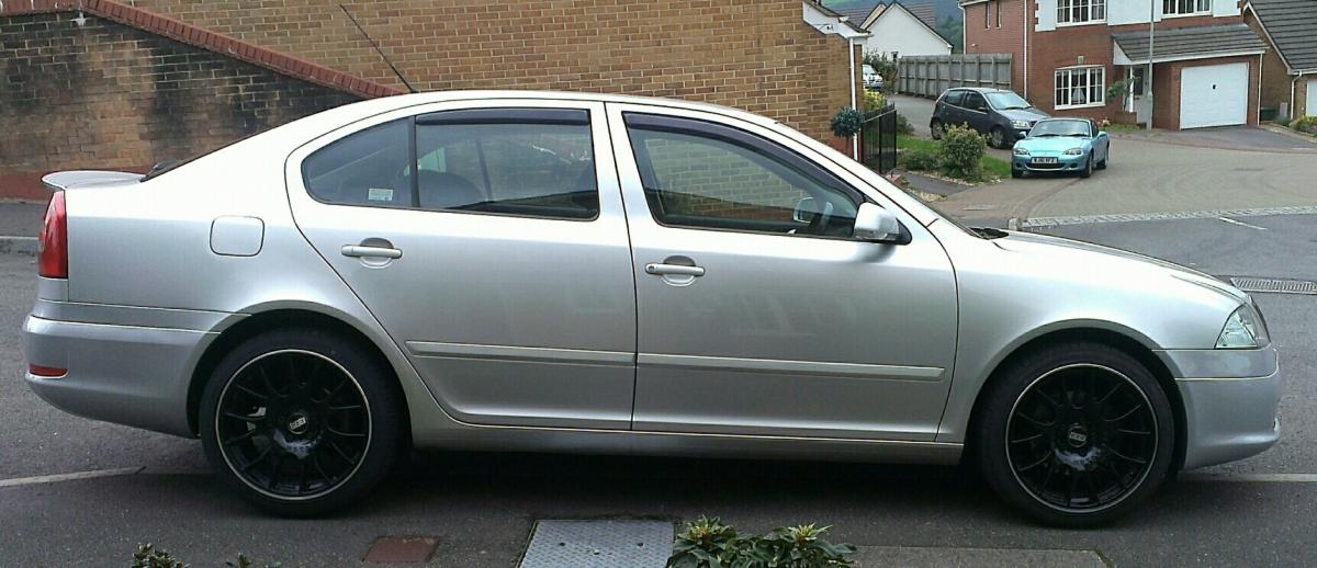

U must be stalking me Mr.......18 BBS CH rims and Bilstein B12 shocks, if u want to buy my car just say lol!
My wheels are black with a silver pin stripe rim, they look lovely on my silver car, not the real deal unfortunately but with BBS centre caps ud never know!

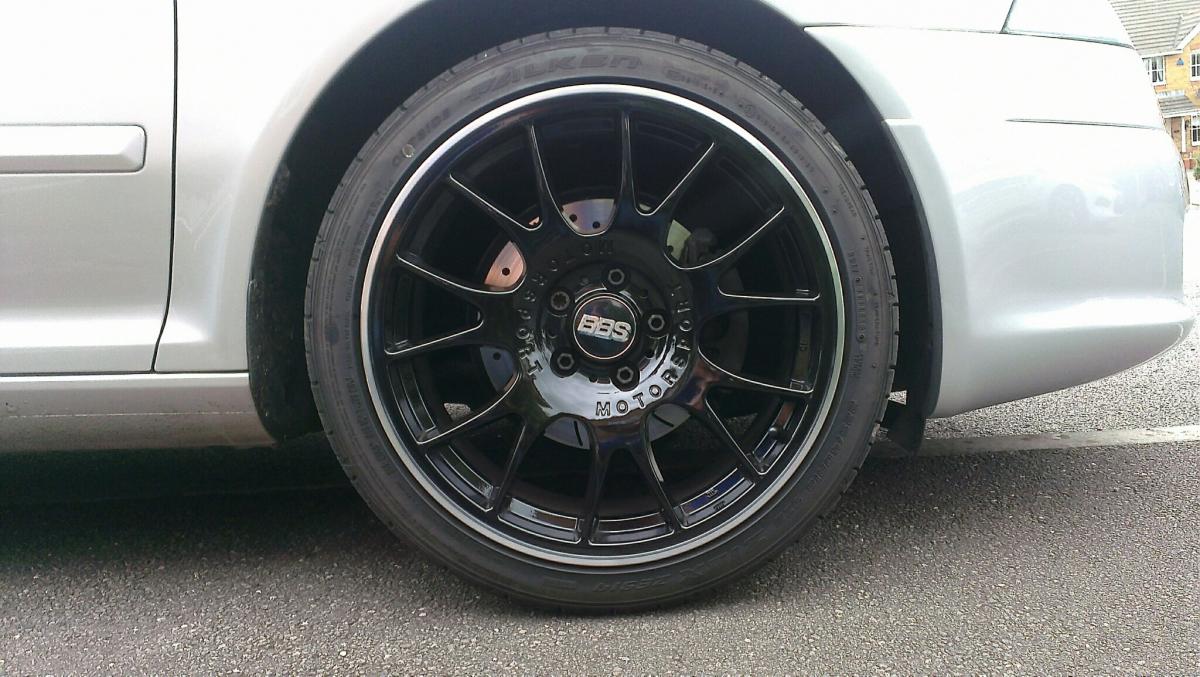

Here's the rims:
Just missing the Bilstein B12's!

Haha im not stalking you mate. And im thinking just plain silver or an anthracite colour?
