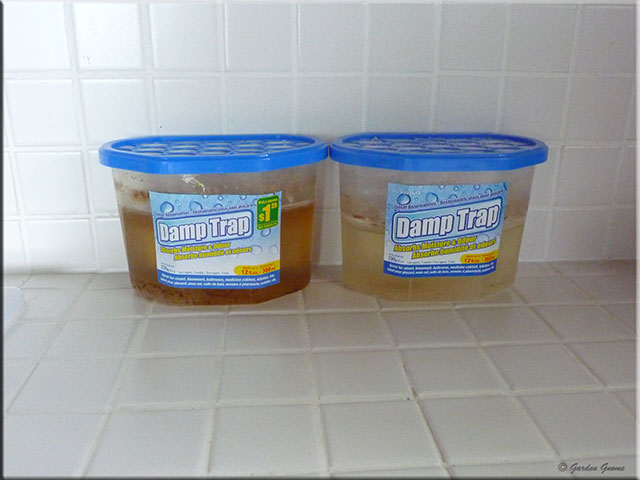

they look something like this, known as a damp trap or moisture trap. Found in the household aisle with the matches, bin bags etc
That's a good idea, never thought of that!
