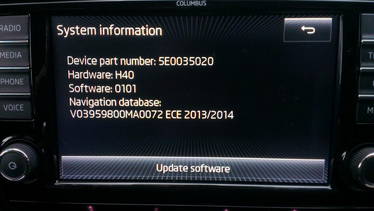

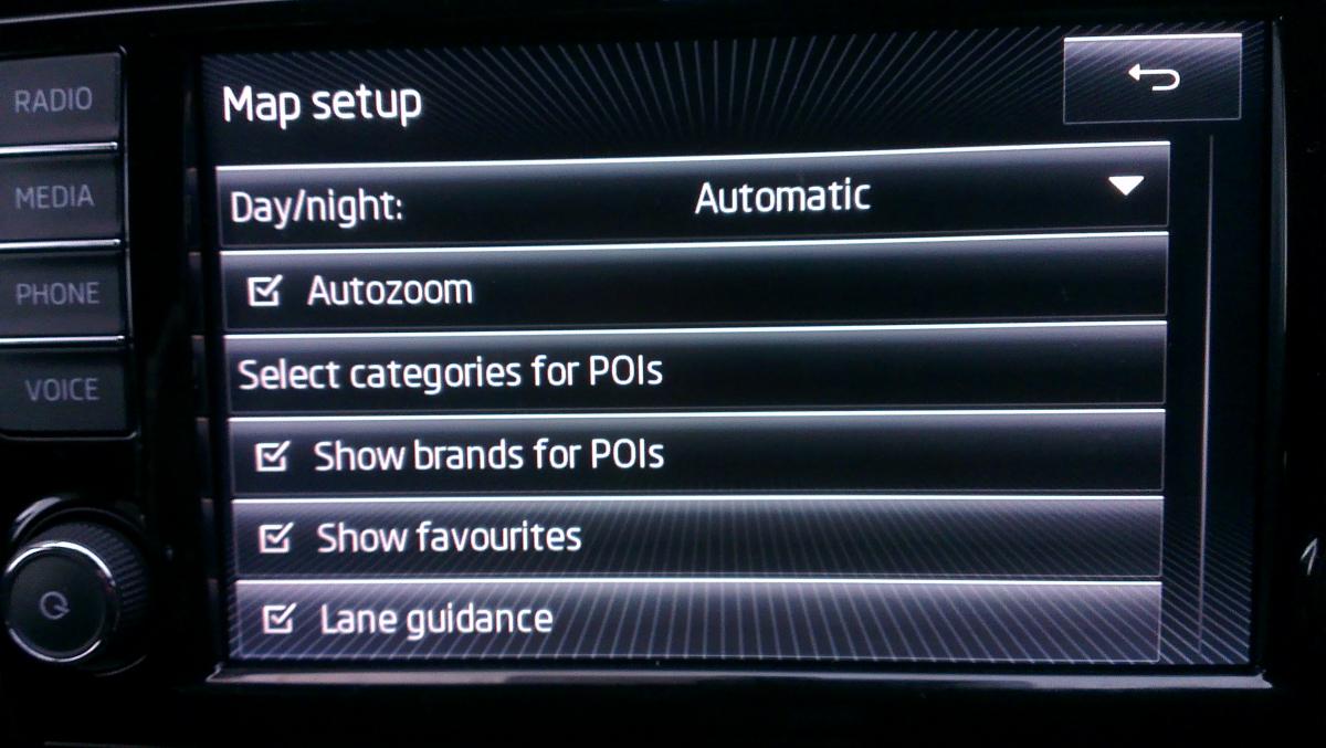

OK - here are my version numbers and I don't have the speed limits, or the option to enable it as can be seen by the second picture.
The dealer hooked it up to VAS and couldn't find anyway of enabling it, and it didn't prompt them that any updates were available either.
If someone without Lane Assist who has the speed limit signs showing please post a picture of their version numbers and the menu option it would be appreciated.

Looks like the software version on mine is slightly later and the navigation database is older.

Thanks for that, do you have anything other than Lane Guidance below Show Favourites?

The rest of the menu is exactly the same as on yours, and I doubled checked once again that lane assist isn't fitted to car.
