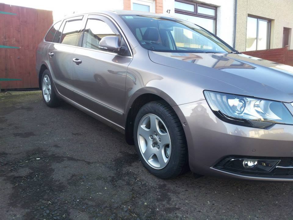

I went for a set of Audi 16" alloys from fleabay and new Nokian WR A3 205/55x16 on my elegance estate, safely stored on wheel tree at moment awaiting November again :)
