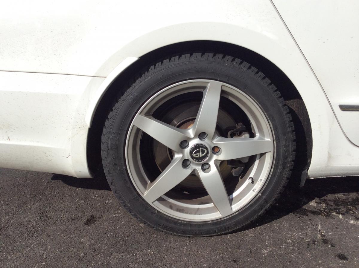

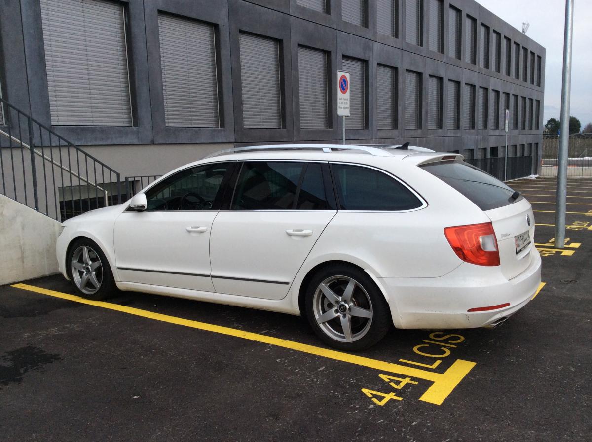

My winter rims are ET36 and 17" diameter with 7.5" width.
Tyres are 225/45/17
ESA Tecar SuperGrip 7+ (never heard of them but were on the rims when I got the car - quite popular here in Switzerland it seems). Spec and review of the tyre below (and some photos).
http://www.tyrereviews.co.uk/Tyre/ESA-Tecar/TECAR-Super-Grip-7-Plus-HP-210.htm
http://www.oponeo.co.uk/tyre-article/the-best-winter-tyres-for-2014-2015-in-size-175-65-r14-t
