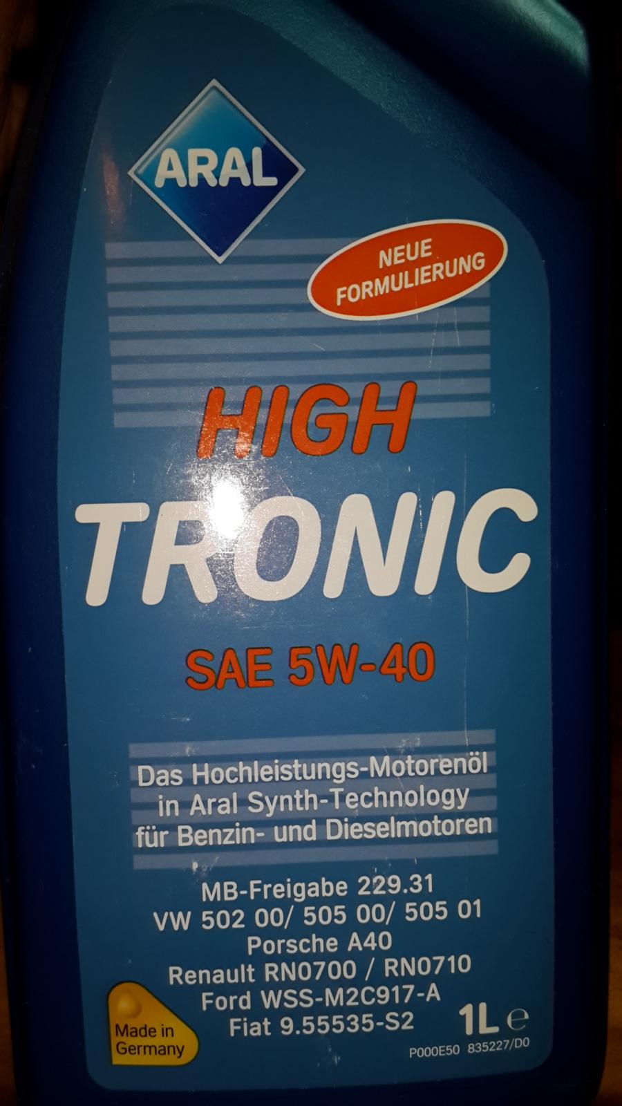

I recently changed my oil (5000 km) and I used oil ARAL High Tronic SAE 5W-40. This oil is under VW 502 spec
Edited by manuelin83
