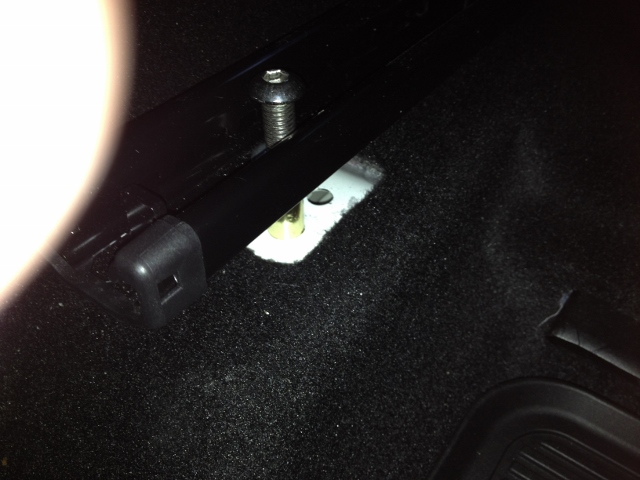

So I decided to put a 45mm spacer under the seat runner at the rear to keep the seat fairly low at the front but higher at the rear...in a better position for me than the standard arrangement.
I did try spacers of less than 45mm but that suited me best

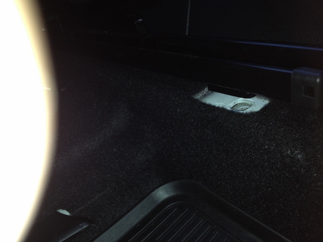

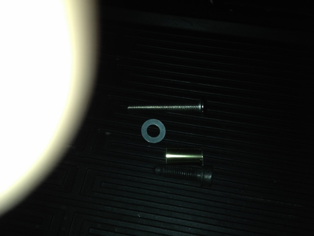

The spacers are some aluminium tube cut to length and placed between the floor and the seat runner.
I have used longer bolts ensure the anchorage remains the same. The existing seat frames are spaced about 5mm above the floor to clear the carpets. I have just extended the spacing.
