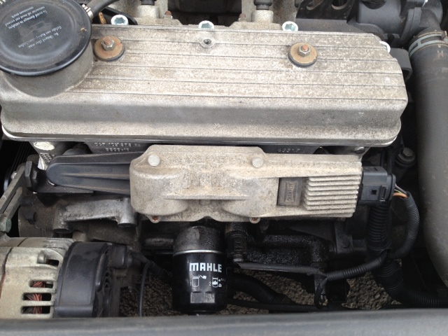

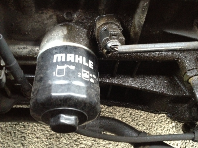

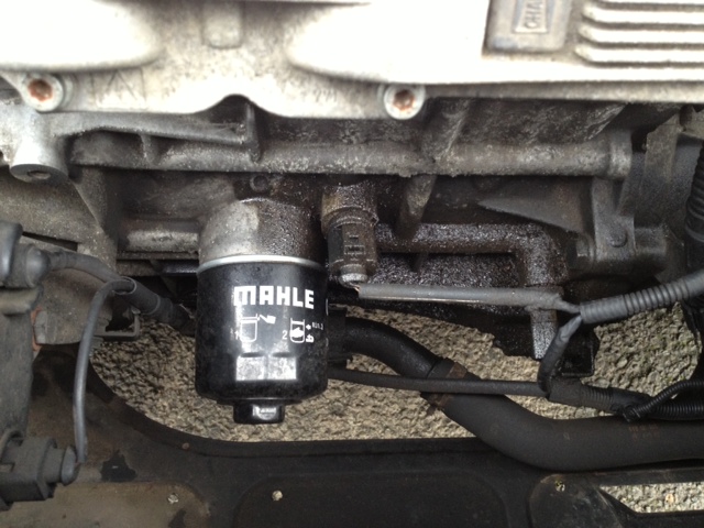

Here are some pictures looking down the front of the engine to help identify it.

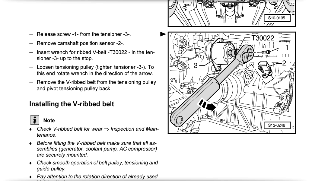

This is a screen cap of the VAG workshop manual for the 1.4 MPI 8V engine. Note Item 5 "Camshaft Position Sensor", the Oil pressure sensor is further along the block, closer to the Bell housing.

Thanks. That confirms it in my mind. Thank you for the screen shots.
Now to source a new seal and see if that stops the oil leak or whether its the other sensor - now identified as the oil pressure sensor.

On my old 1.4 MPI, the oil pressure sensor failed, and it was leaking oil through the actual sensor itself, so when i removed the loom connector oil was coming from the electrical contact itself, this fault first arose as the Oil warning light was flashing while driving. If your not having that fault condition, I would assume that it is just the o-ring around the cam shaft position sensor from looking at your photos.
Is there any oil on the engine block under the Coil pack? It could be a leaky valve cover gasket.

IIRC The Oil Pressure sensor doesnt have a seal, because its just a brass threaded part. which screws into the block. To be honest it was about £3 inc VAT from my local Skoda dealer, so it wouldnt harm to change it, i just drain a bit of oil out, fitted it, then topped the oil back up.
