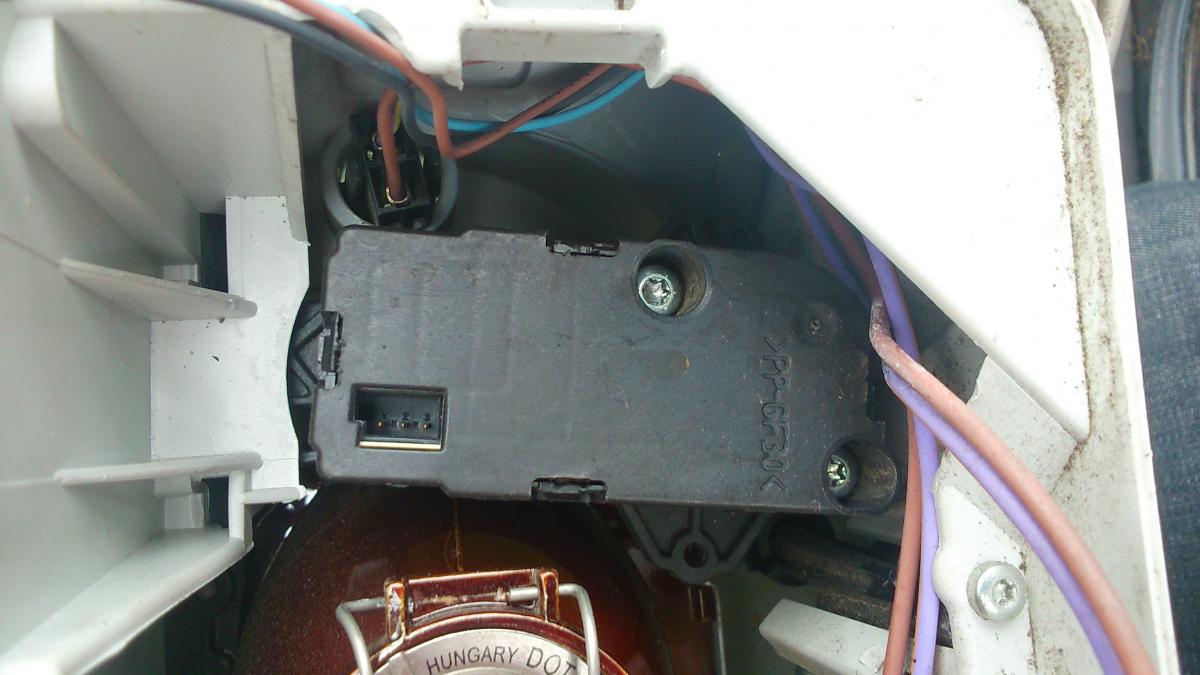

Struggling with a sidelight on my 2007 Octavia Sport. Can get the headlight unit out ok. The sidelight is in a black plastic box beside the headlight bulb and indicator but the black plastic box doesn't look like it comes out. Should it open? There looks to be a small tab on all 4 sides but I can't see which way they move.

Pic
@Daveyraveygravey the sidelight is the connector to the top in your picture.
One tip for you, do not put the sidelight holder back into the headlight until after you have plugged the headlight in and confirmed that the sidelights work correctly, or you may just find yourself going through the ridiculous removal procedure needlessly for a second time.
Ah, thanks Simon!  I guess the black box thing is the indicator assembly then?
