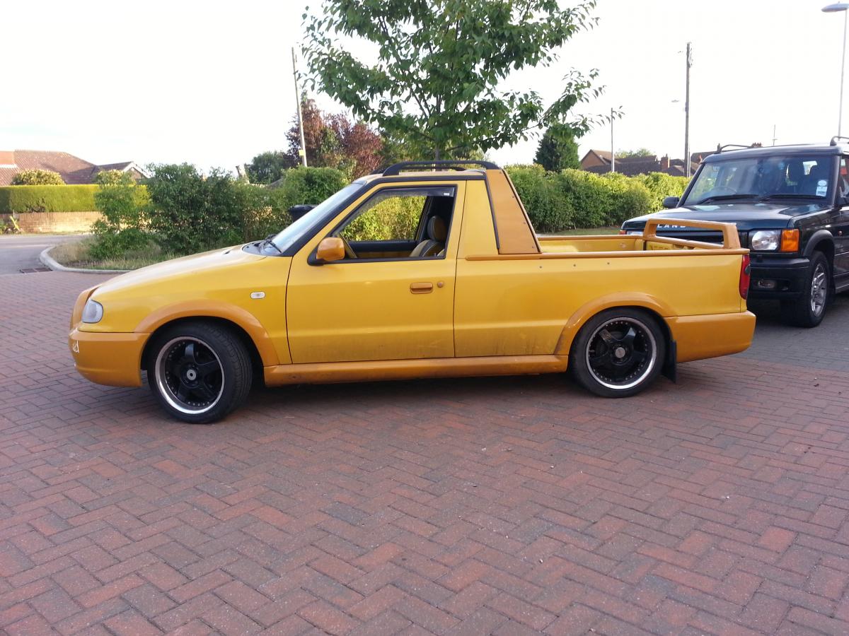

i got 195 50 15 on front............. no issue
i got 195 55 15 on the back.... but had to fit 9.5 mm spacer as the tyre was wayyyyyyyyyyyyyyyyyyyyyyyyyyy to close to brake pipe

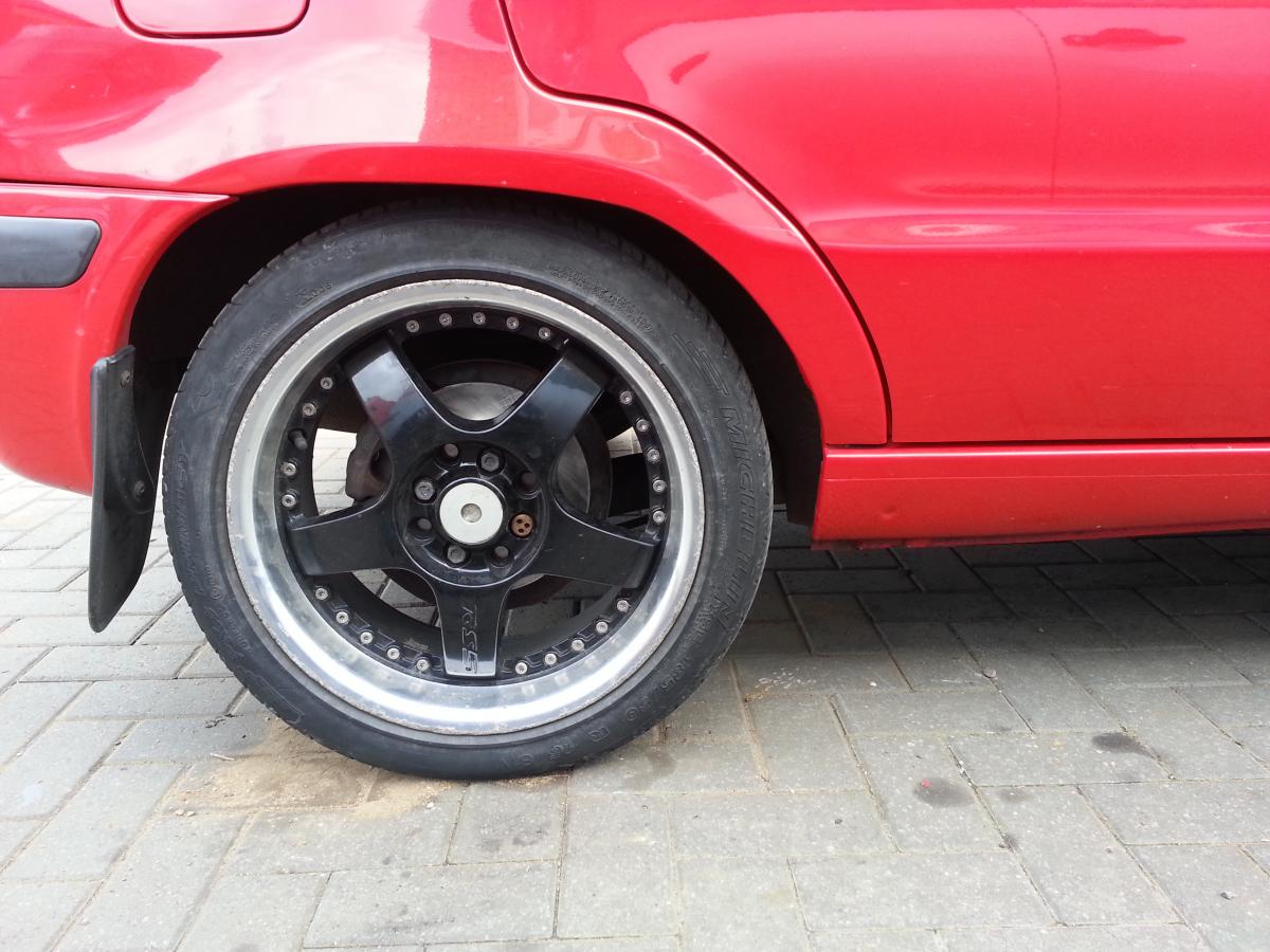

I have 16s 7.5j with 185 50 16s and only just clears front spring cup and only just fits the rears on my lowered fun and fitted my slxi conversion to with rear disk conversion
Fun
Slxi conversion with rear disk
