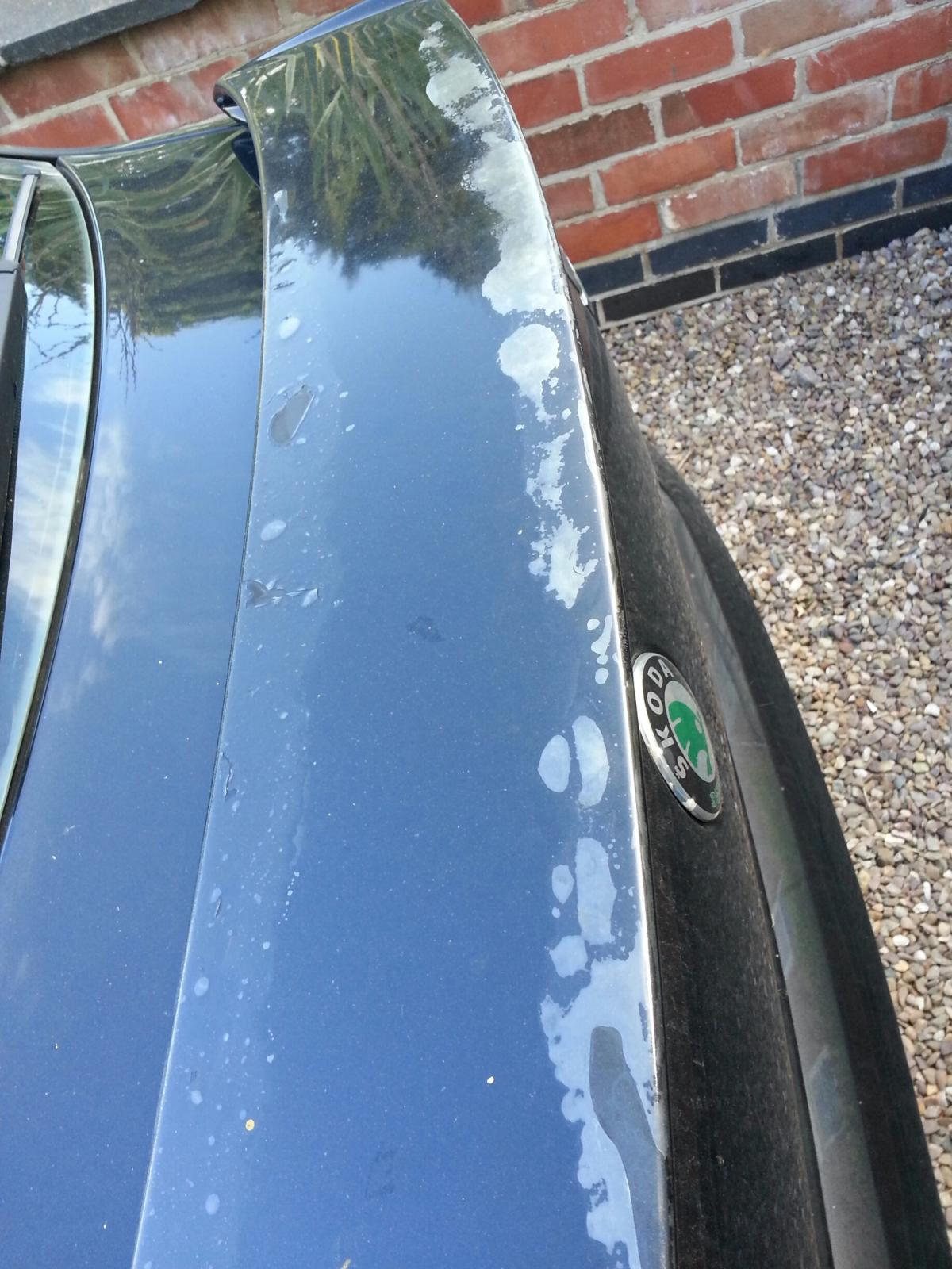

Octy 2 vrs Spoiler blistering!

I swung by the dealer this morning and asked one of the guys in the body shop to have a look. He confirmed it was blistering and took photo's to send off to SUK to start a warranty claim. He said it usually takes 48hrs to receive a reply to each case. I am now waiting to hear. I will keep you all posted.
Oooh forgot to mention - The guy said this was very common. Hmmm. Glad I noticed it whilst it was still in warranty.
Edited by radders567
Just been back to the dealer to have my spoiler removed for repainting as my case was accepted. Dealer came back in after a few mins with more bad news. He had found some more paint bubbling under the spoiler so now the whole boot lid is going to be painted as well.

It's because the clearcoat on the spoiler isn't of sufficient quality and/or thickness. Clear manufacturer defect, especially seeing this exact problem occurred on the Mk1 Fabia vRS rear spoiler.

I had a large blister on my spoiler last year
didn't even bother with Skoda as out of warrenty and paint is only covered for rust so went to an independent who i must say was surprised to see it and claimed he had never seen anything like it.
When i dropped the car off he managed to cut the lifted clear coat ( approx. patch 3x4 inches ) and we examined it only to find a small hole with a mark in the paint where the hole was. best guess was a small stone managed to hit the spoiler and water got under the clear coat managing to spread out when the cars at speed. The hole couldn't be seen whilst on the spoiler but with light behind showed up.
repair cost was £120 for a total spoiler respray

Thought mine was bad chunks just falling off about 2 inch not properly lacquered on the corners but having seen steve33 spoiler that is a disgrace.
It didn't like three weeks at Manchester Airport to be honest! Wasn't too bad before then.
I got mine done a while ago at a private paint shop for £80, jobs as good as needed and at £80 notes it was a cheap fix to an awful problem..
Apparently its got something to do with the releasing agents they use in the moulding process not being fully cleaned off, so eventually it bubbles the lacquer and away it comes, cheap ass skoda!!
