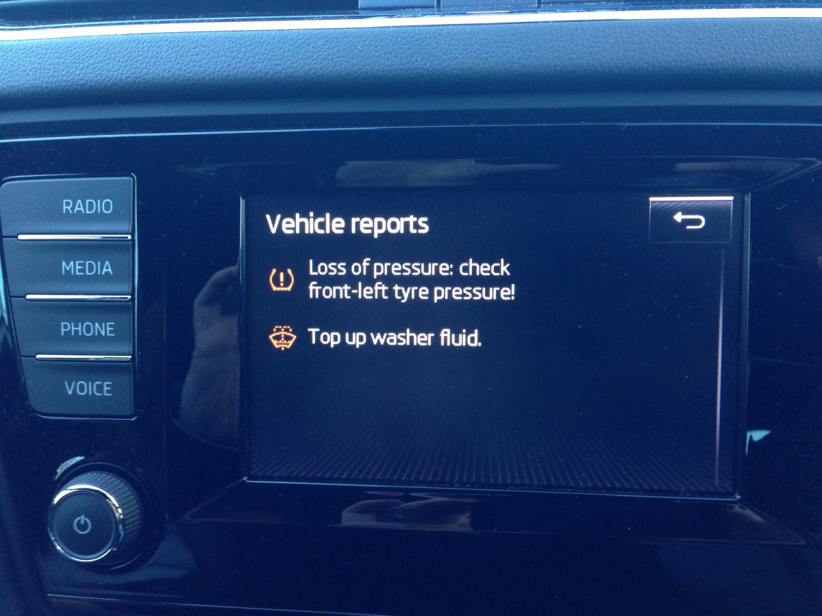

After swapping to my winter tyres the next day a tyre pressure warning popped up - and it does tell you what wheel to check. So it may not have actual sensors but it can't be too bad. It was only 5 or so psi down too.
Nice improvement to TPMS on the Octy3 there then, like it :thumbup:

Very interesting; I picked up my VRS Estate on Tuesday; Winter tyres fitted on Wednesday at 60 miles and since then have had a problem with the TPS twice - it showed 'Error Tyre Pressure System'. Checked all four tyres both times, no loss of pressure. Called at Dealer, very helpful but thought it might be a slow puncture as apparently the new system is more sensitive than the MKII. BUT, there was no mention of an individual tyre AND it did say 'Error' - might I have a problem?
Have you run through the TPMS reset procedure? I presume you have.
Yes, thanks, it was done both times. Just keeping an eye on it now and will update this thread if the problem reappears.
The first time I drove on a motorway after getting my new Octy the tyre pressure warning came on even after I initially set the system up & checked the pressures. I re-set it & never seen it since. A friend who runs a Passat has had 2 sets of new tyres whilst being the owner & both times even with correct pressures set the warning came on. Guess the system needs to be re-set before it decides the pressures are fine.

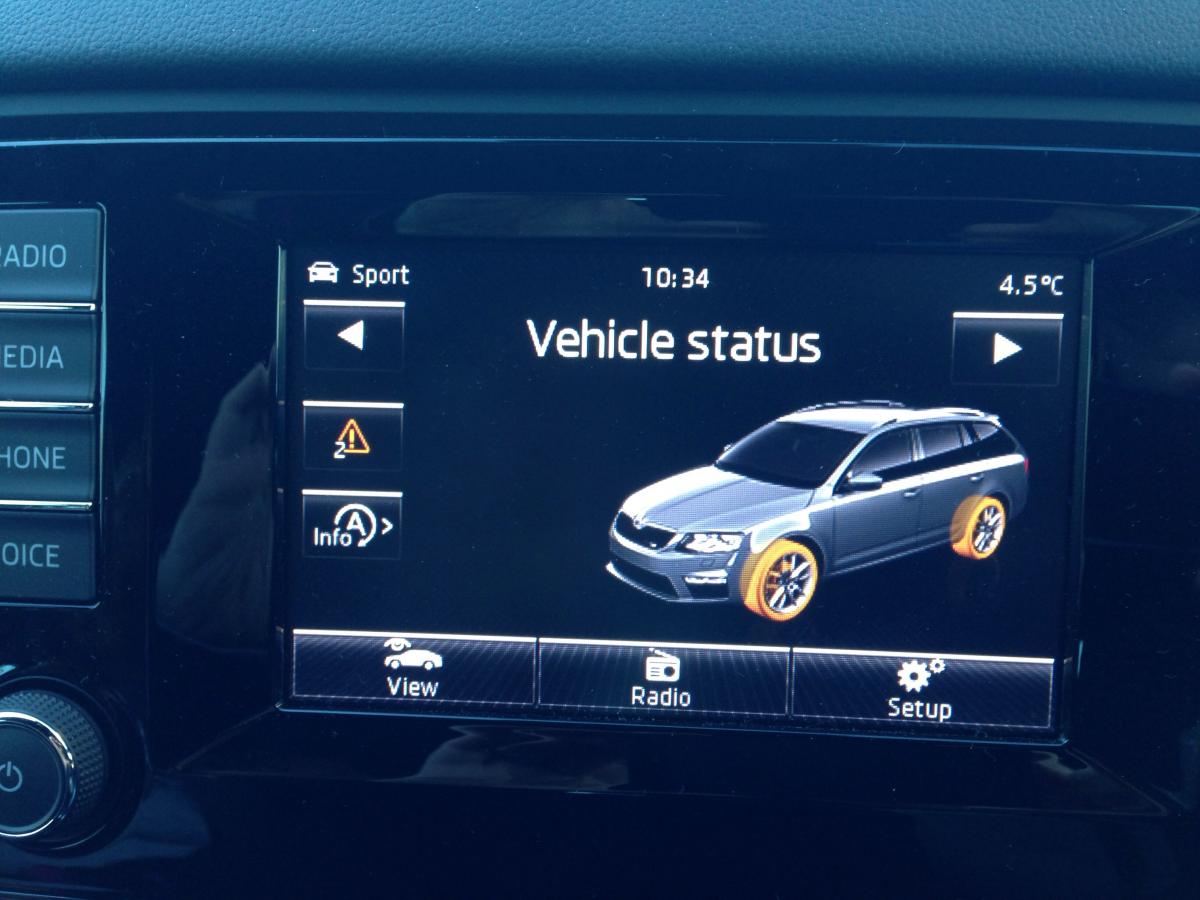

Had mine go off late last night on the way home. It said that all 4 of them were at fault but I couldn't find anything wrong with them.
Anyway checked them today and it was right all 4 were at all different pressures and once I had done it and set it its been fine.

Car complained of the two near side tyres being incorrect pressure. Just assumed it was the tps playing up as it was new tyres.
Turns out kwik fit had actually put the wrong pressure in the two nearside tyres.
