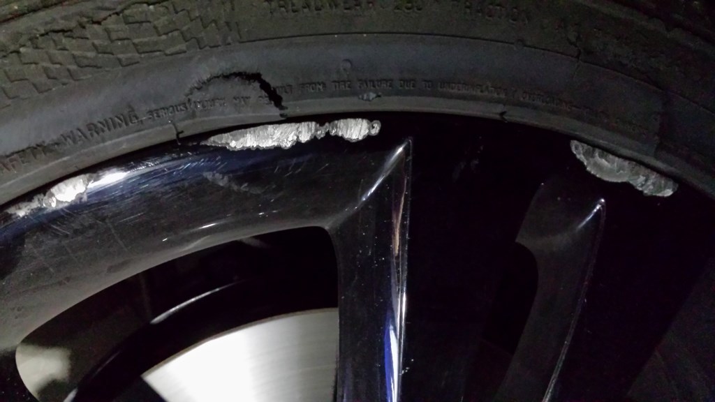

Quite badly curbed alloy - options?

Well I've had a reply from one of the three companies I dropped a line to.
The guy is mobile, so comes out to me. Does the repair, bakes the wheel for a couple of hours and says I'll be back to showroom condition based on the pictures I sent him.
Quoted my £70 for the work, which I guess is a damn sight less than a new wheel and the fact he's mobile will make things easier - suggests I don't drive for an hour after the wheel is re-fitted and no jet washing for a week.
That's a 'smart repair' in effect.
If you think that's overall easier for you, then you need to factor that in as well. Personally I'd go for a proper tyre off refurb and know it had been fully cleaned, blasted, dipped etc. And I know that can be done for £55 per corner, including tyre removal and re-fitment. But a lot depends on the area of the country, and obviously knowing somewhere good to get it sorted.
I think the fact I literally get to sit back and let him do the work outside my place is worth a few extra quid to me.
He offers a "12 month guarantee" and of course tells me that nobody has ever had to use it.......
I'm arranging for him to come out on Saturday so I'll post some "after pics" once it has been done.
Thought you might say that :)
OK, for completion I've added a couple of pictures of the repaired wheel.
When the guy popped around I also noticed some damage to the rear wheel on the same side, so I decided to have them both done - paid £55 for each one.
I've tried to get the same angle as the original picture for a proper comparison.
Cannot fault the work really. He was here for nearly 3hrs - I just kept him topped up with tea and gave him access to a power source.
Both wheels looking as good as new.

Looking good. I had a local guy sort out some damage on mine and was also pleased. In fact as long as there isn't a massive chunk of alloy missing I would be OK with a smart repair. The local Mercedes dealership uses him to sort out all of the used stock so I guess there are a good number of people driving around with smart repairs unaware.
Well it looks pretty good, I take it your repair is filler and not welded or crack tested
Nice result that. Looks spot on :thumbup:
For a small repair, on an otherwise A1 wheel, it's a decent option - and less hassle as you've found :)
I've got to get my nearside front kerbed neptune (Blackline vRS) repaired after some avoidance tactics required from an oncoming!  Sidewall is torn but local tyre dealer said I'd "got away with it".  So the alloy is quite badly scuffed .... Had a horrendous quote from Alloy Weldcraft in Wycombe who really didn't seem to want my business and gave off some serious bad vibes - so bye bye to them.
Had a good chat with a mobile service called "Revive" who appear to be a franchise type set-up.  Bloke said he'd charge £65+VAT per wheel including repair/fill/repaint on my own premises.  Anyone heard of them or used them?
Piccie attached.
