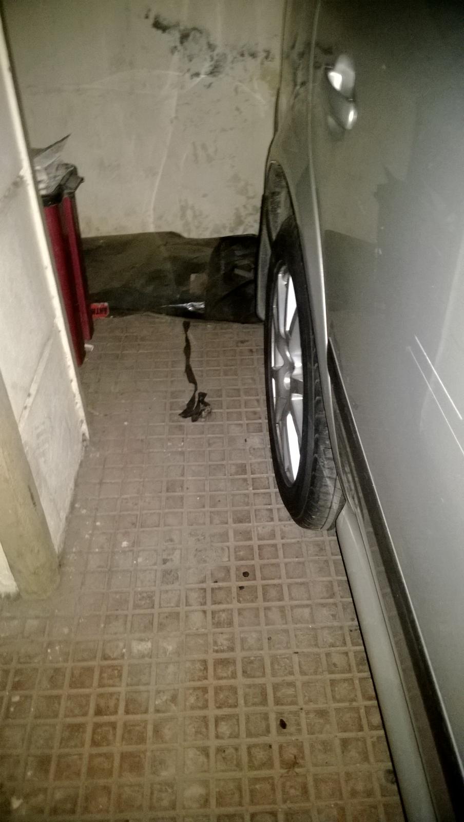

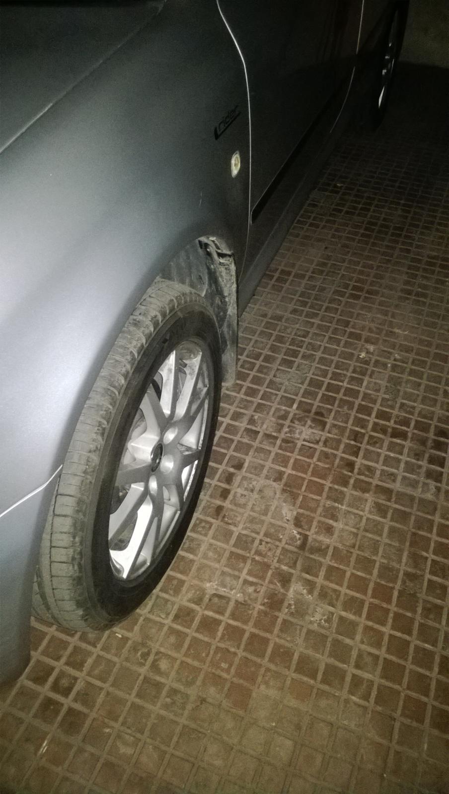

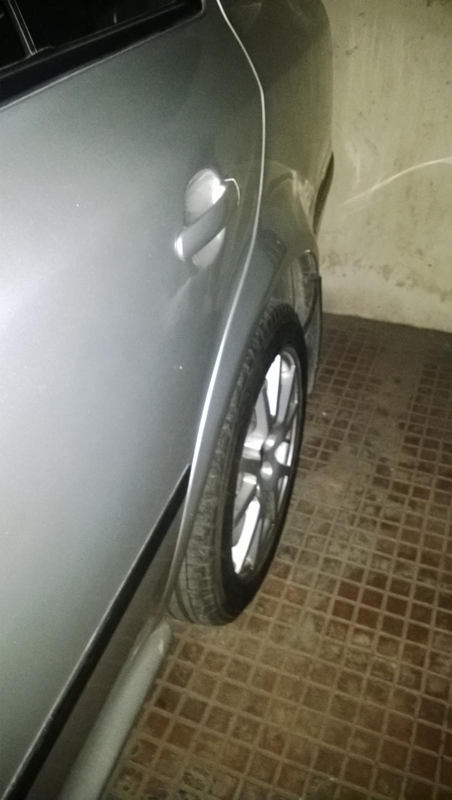

Hi, i seem to have the exact same problem. My skoda dealer has informed me that the rear axle beam is bent but he said it doesnt need replacement just yet as the difference in camber to the allowed limit is just 1 deg. I've just shod the car with Yokohama dBs so i am worried that the inner edges might wear out sooner than usual. When i look at the car, the rear tyres look slant ( In at the top and out at the bottom) compared to the fronts. I've seen some other cars and all look similar, some even worse. Now, my doubt is if this really is a  problem and if it is, is the axle beam replacement the only way or can i try fiddling with the shims? Please help. I am attaching a couple of pics that i just took and if needed i can take some pics during the day tomorrow and post them. Thank you
Rear Right
Rear Left
Front Left (just for reference)
