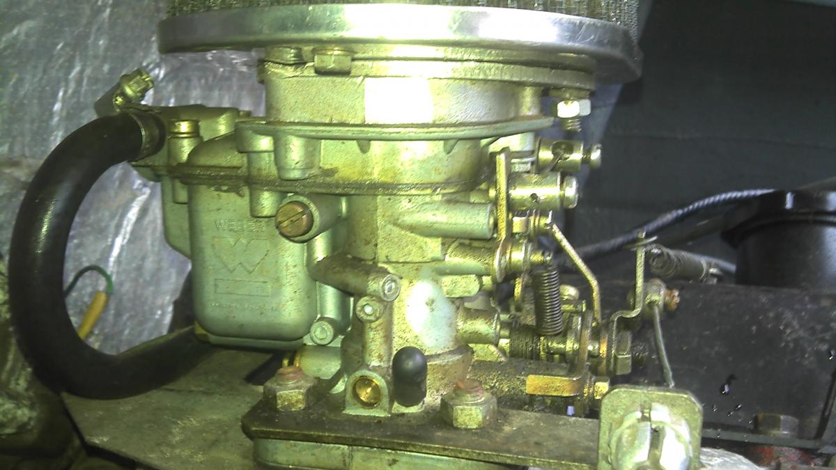

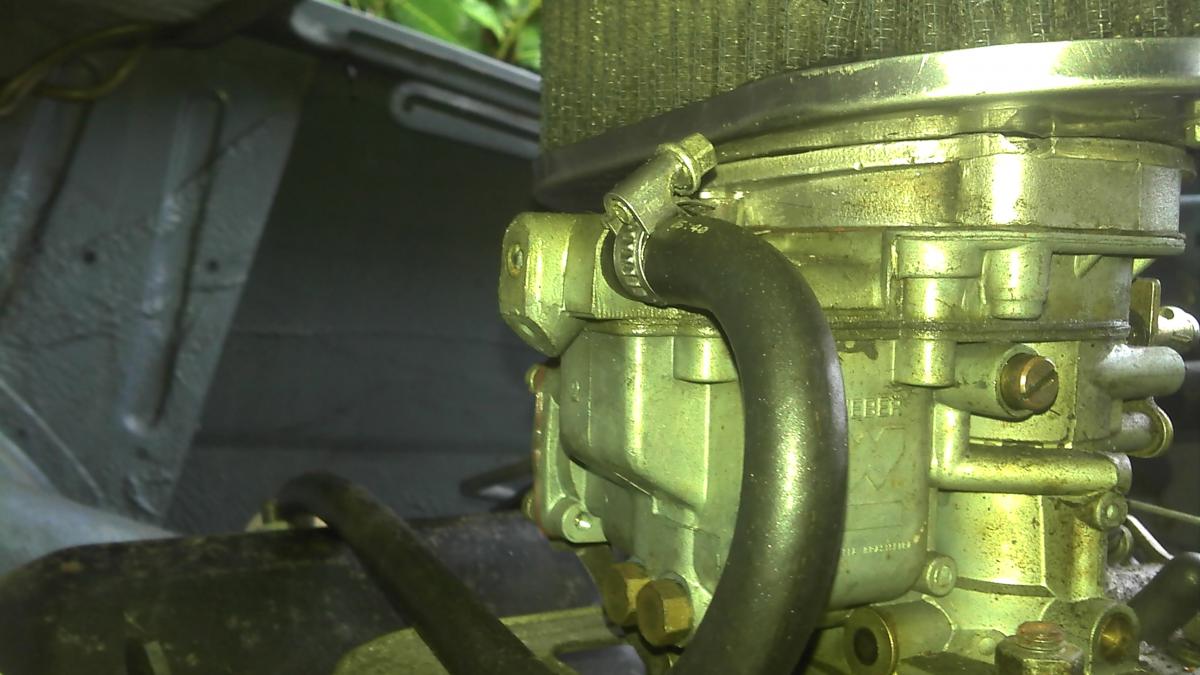

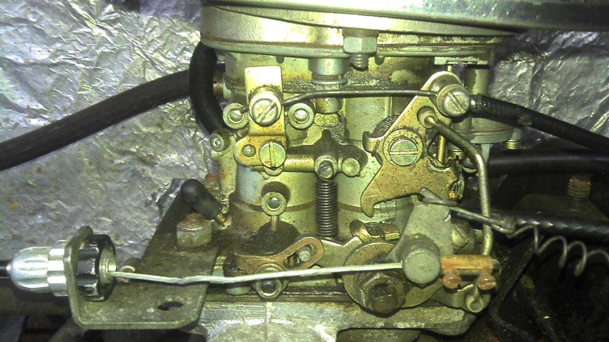

I  decided to M.O.T the skoda recently ,after being off the road for 5 odd years, obvious FAIL but hey it was only a brake light , seatbelt, and emissions!!
  the emissions sheet i have states a failiure on Co level of 11.88%  when it shouldnt be over 3.50%. not a problem i thought i just lean the mixture and make sure its cooking hot before the next retest. but now i cant identify my carbs to enable me to find a diagram to locate mixture screws etc.
 so i just wonder before i go for retest, what Co levels are any of your guys similar engines achieving? or if anyone knows the factory standard? cheers
:happy: Can you show us a photo of your carb?  The original Jikov will happily idle at 0.3% CO if everything mechanical is sound, but it will idle at it's best at between 1 and 2% CO and also reduce hydrocarbons.. Weber carbs need to run a bit richer, usually between 2 and 3% CO.
. I think the carb is a weber 450 mini progressive,although im not 100%. i cant seem to add any pictures??? it tells me uploads are not allowed. not sure how to reticfy this ,any help appreciated.
there we are!
