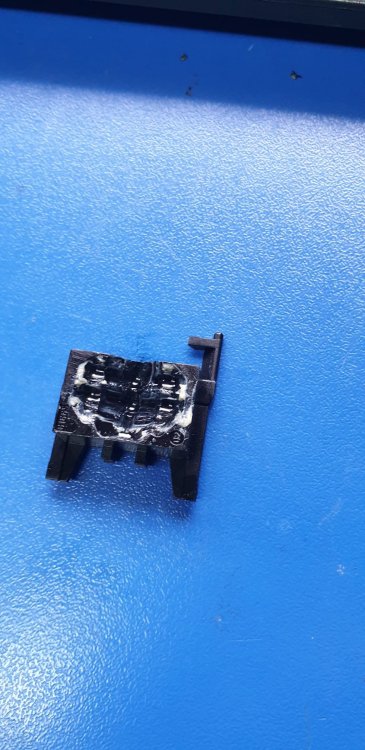

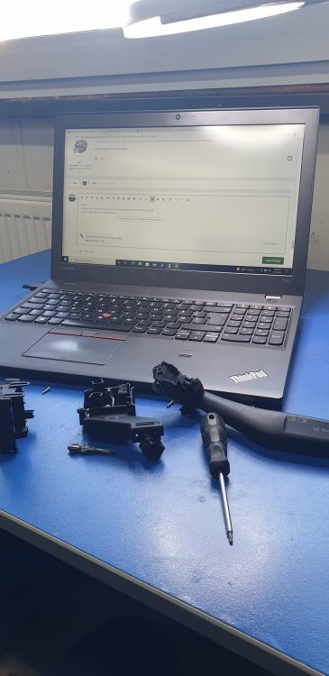

But I can confirm that a G version stalk can be modified not to stay forward. so it works like the newer stalks
So whats the mod?
you need a newer style stalk, doesn't have to be a cruise one.
open it up
there is a cap that goes on the end of the stalk, swop them over and the older style stalk will return
Aha, interesting...im thinking about doing that, because the bronken-module doesn't show the icon in the maxidot. It works independant from the bcm. So do you have a partnumber for the new stalk, and maybe a piccie of the cap?
Edited by Too Tall
Anywho, thanks to Eddie-NL I got that modification of the highbeam stalk done. Mod is pretty straightforward, as long as you're comfortable taking off airbags and steering wheels :giggle:  My stalk now returns to center when pushed away from the dash.
(Note the FLA module from Bronken.de was removed for this experiment)
After coding "momentary highbeam switch installed", and re-coding the HBA, it does not want to go live. So there. Doesn't look like this is a way to get it to work on older, non-compatible cars.
