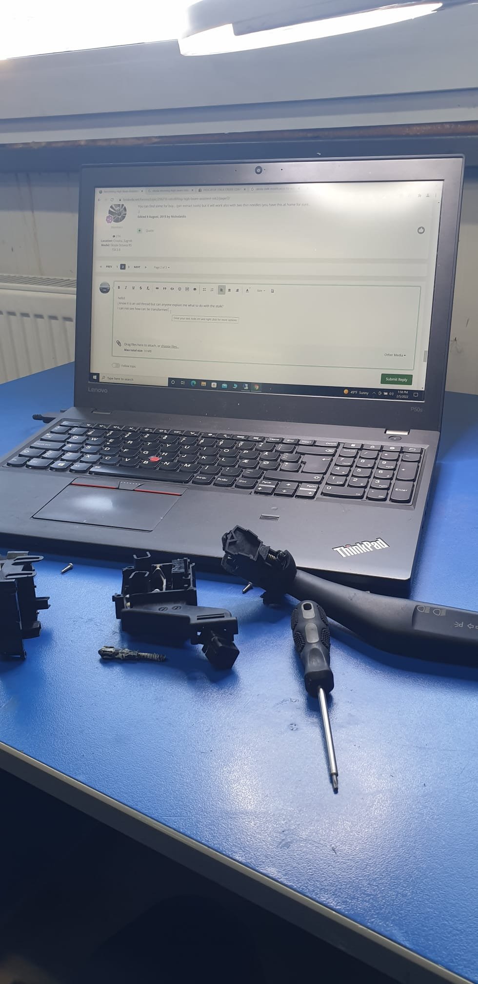

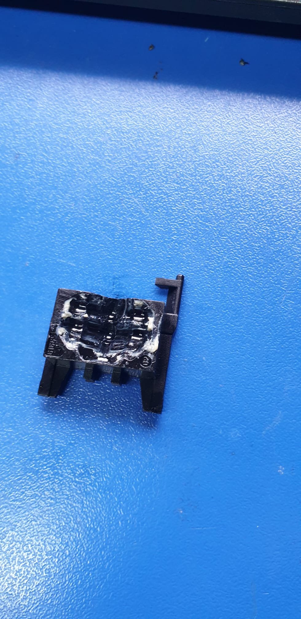

  • I think it is possible to upgrade, although you would have to change several parts   Combination stalks newer controller new steering lock new base plate for stalks change the plugs for the airb
  • you need a newer style stalk, doesn't have to be a cruise one.   open it up   there is a cap that goes on the end of the stalk, swop them over and the older style stalk will return
  • LasseTheDude
    LasseTheDude
    Anyone? Can't wait to get started

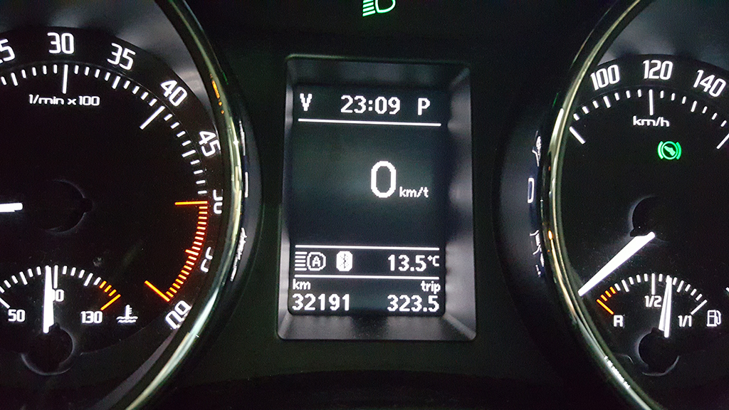

IT WORKS!!! :D
I use the xenon leveling module. And it totally works.. :)

hello!
i know it is an old thread but can anyone explain me what to do with the stalk?
I can not see how can be transformed ?
Sorted out!
This is the piese ...
I replaced it with one from golf 6
