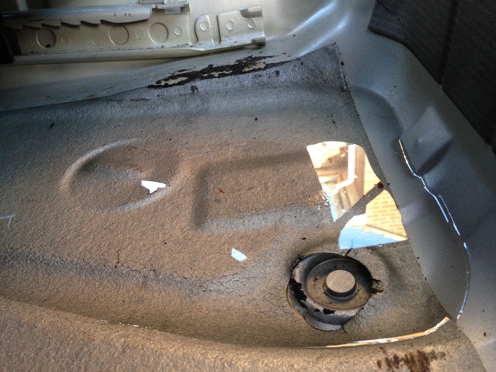

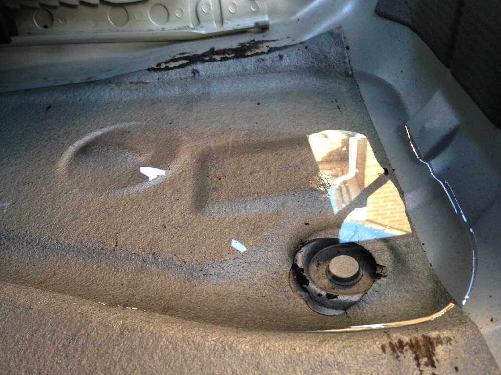

Went out to the car earlier and noticed that Santa has converted my car into a mobile swimming pool lol.
where is that the floor pan??

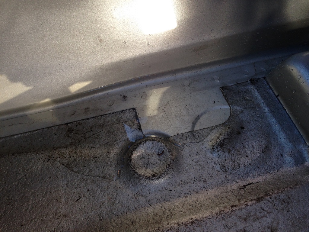

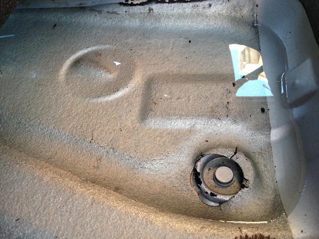

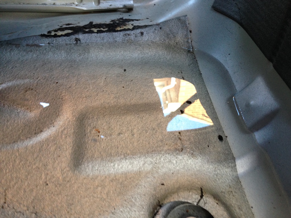

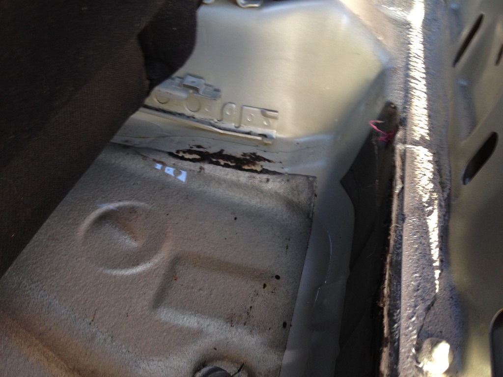

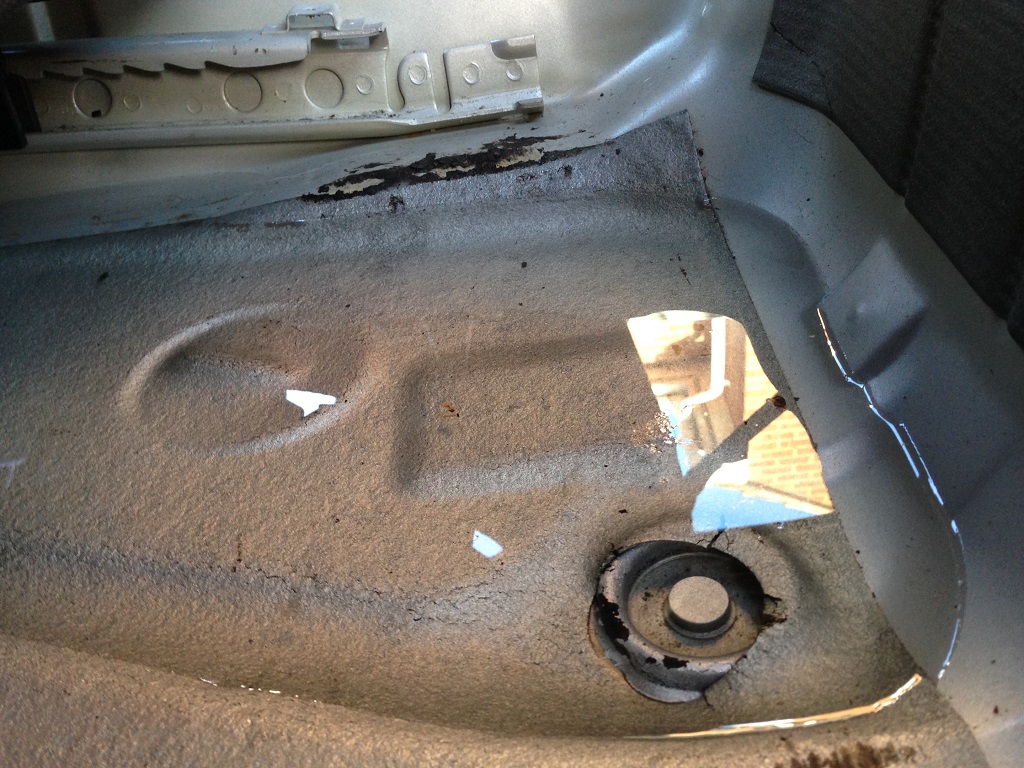

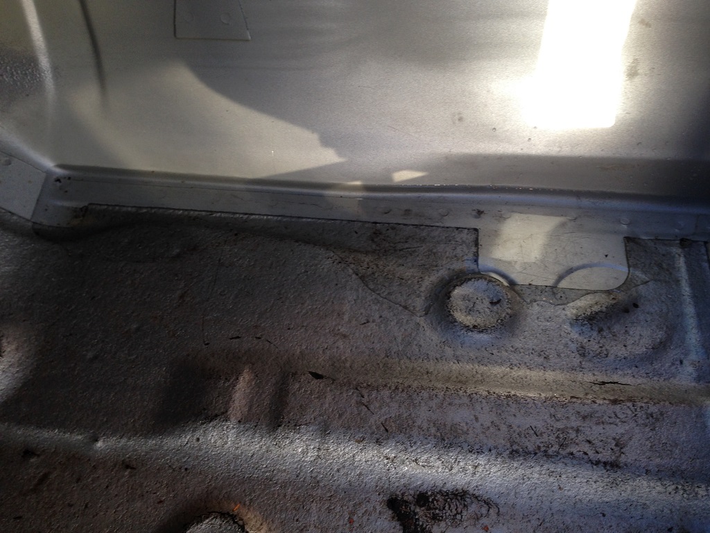

Passenger side, first pics are the front along the transmission tunnel, the rest are the rear foot well.
Heavy rain again last night, and today the rear passenger footwell was full of water again.
The passenger rear door was also wet inside, but no obvious sign of the drain holes in the bottom being blocked :wonder:

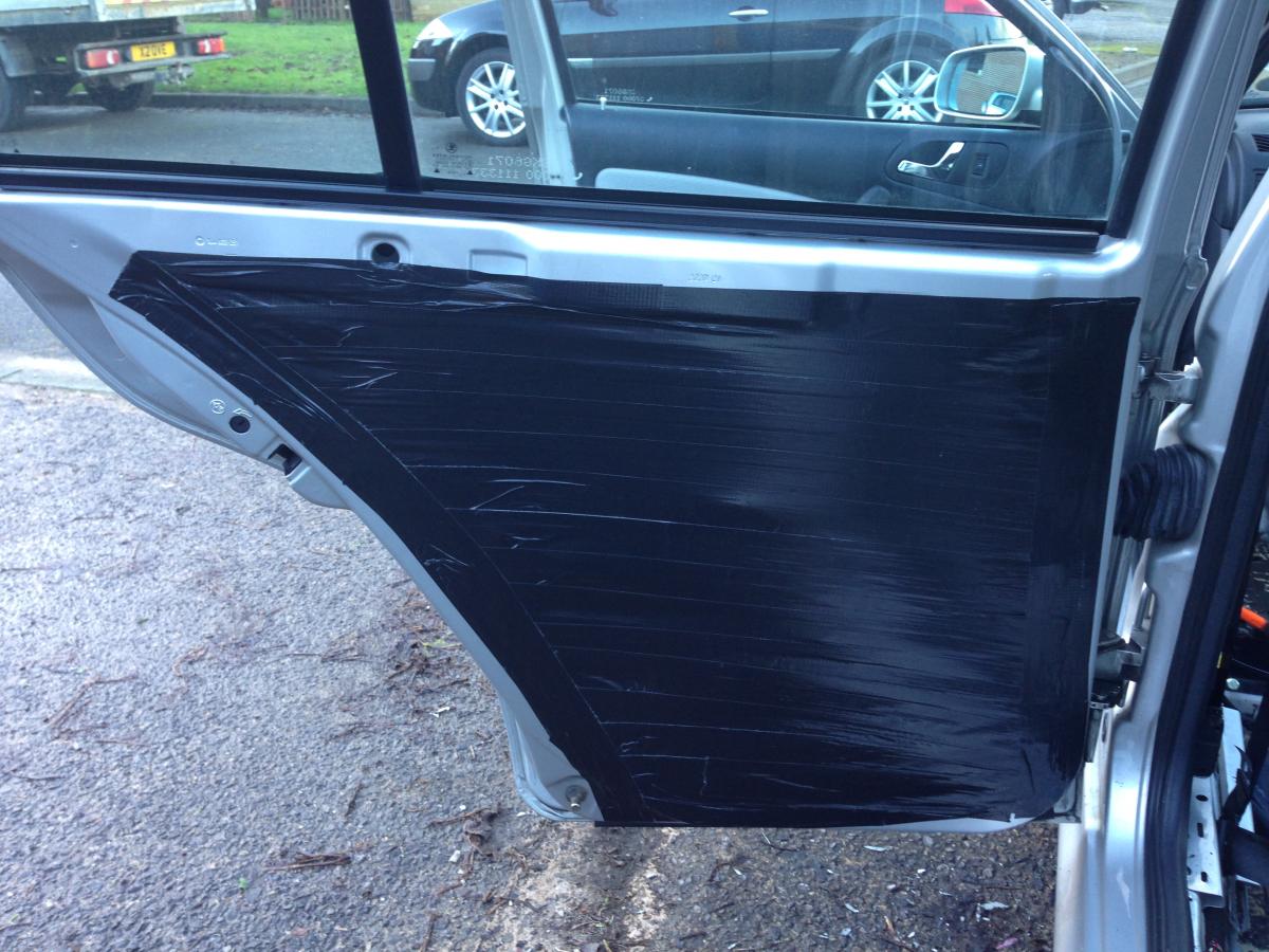

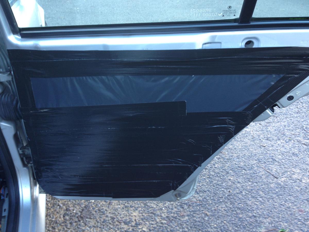

Well I had to drain about 2 litres out of it again this morning (it rained heavy for the last 2 nights), so I thought it's time to do something about it now.
I went to B&Q and bought some thick polythene rubble bags (£3 for 10) and a large roll of duct tape.
This is what my new rear door membrane looks like now :D
Sadly on the other side I ran out of tape, so it doesn't look quite so good at the moment, but atleast they should both be water tight now.
I also removed all the sound deadening from the passenger footwell (front and rear), what a SH1TE job that is, taken me nearly all day, my hands are killing me, and I still haven't finished as I need to get the remainder of the glue off the floor as it looks really messy now, but I had to do it, as there was alot of water trapped under it, and I have no doubt this would have caused me lots of problems later on.

Well the new rear door membrane didn't fix anything.
