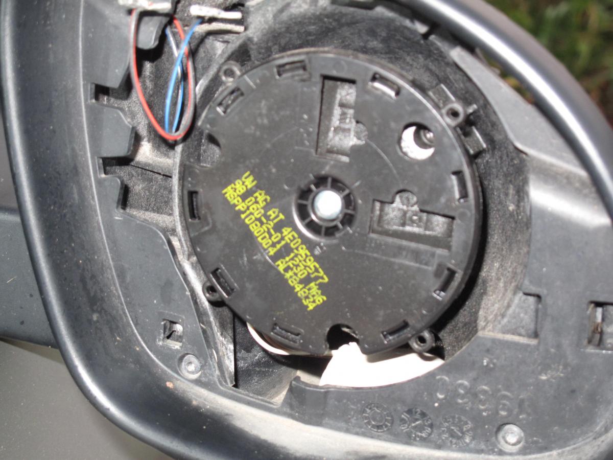

Just been to have another look and indeed much of the mirror is there!   It appears that the mirror adjustment pad works OK as does the indicator section.  Perhaps these bits can be reused? The front mirror is missing and the upper portion of te rear shell is gone. the lower portion with the indicator light os theer but maybe the plastic clips have sheared.

Anyway I now attach the photos.
That looks like you just need the top cover and glass.
I hope you are correct.In addition the rear colour matched shell has gone. Maybe the guts can be retained OK
I'd be tempted to replace both sides in gloss black on a silver Yeti :rofl:
Apologies but I think there is a little more broken, as by looking at the pics the rear frame appears to have separated from the lower front section containing the indicator. The two torx screws that can be seen at the bottom of the mirror housing aperture should fix the frame to the lower housing, so I suspect the lugs have snapped off :(

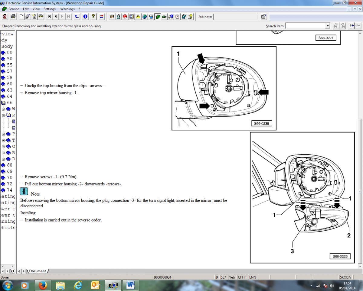

Parts breakdown can be found here (in Russian, so need google translate);
http://vagcats.info/base/sk/3/238/666/8/9521
Will throw up the workshop guide in a minute; need to take some screen shots.
