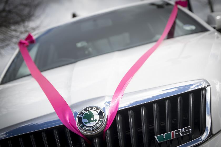

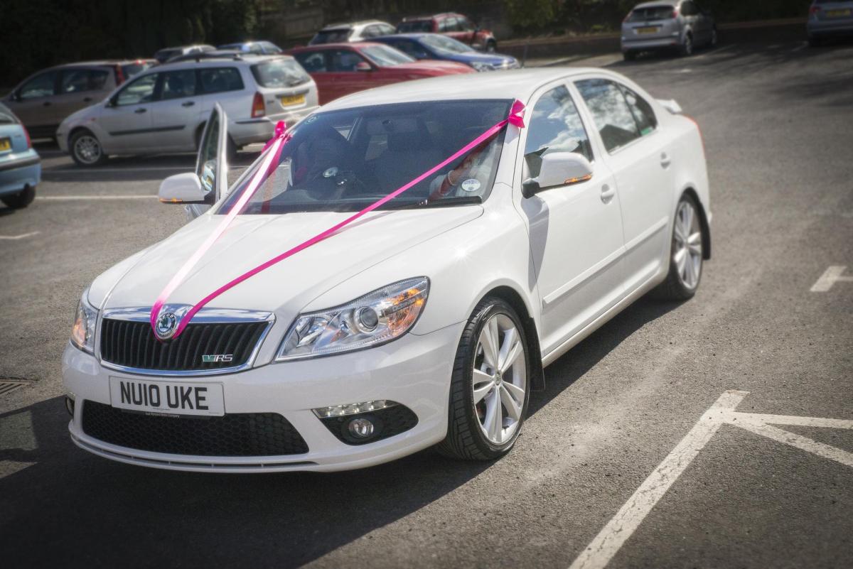

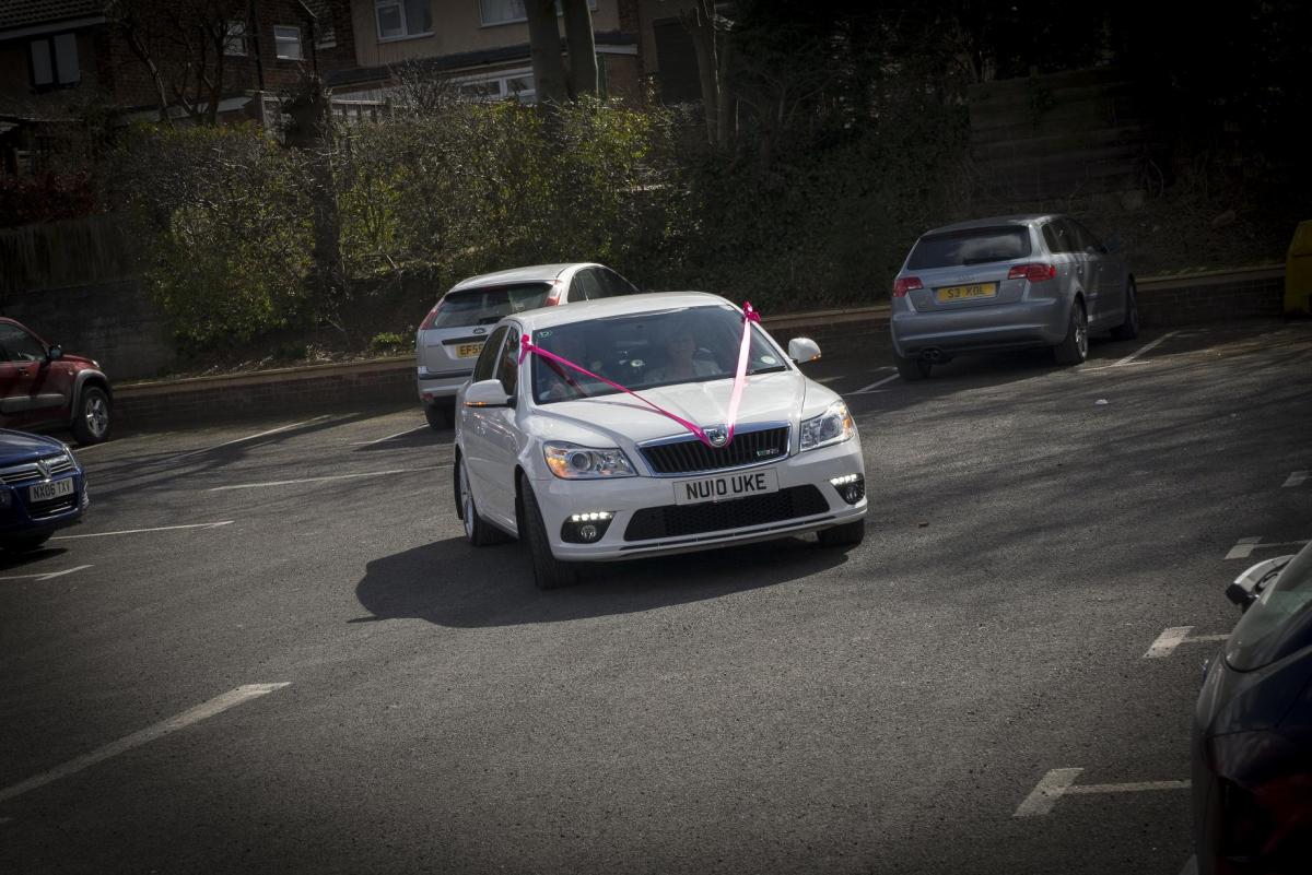

This is my lovely car and was detailed by Shaun before my wedding last year. As we were using this as the wedding car the only stipulation from the wife was that it had to have clean sills, and with Shaun's attention to detail there wasn't a spec of dirt to be seen anywhere!
As soon as I walked into the workshop (very professional and clean looking place by the way!) to collect the car on the morning of the wedding I was struck by just how much newer the car looked. As mandp said, I was terrified to take it outside as the roads were slightly damp and would have chucked crud up the side and rear of the car - not what I'd want on the wedding pics! Thankfully the products that Shaun used allowed most of the muck to bead straight off and anything left once I arrived at the destination simply ran off when water was applied with no washing required. While the women at the wedding commented on the wifes dress, the men were all commenting on how great the car looked :)
I'll upload a pic of the car at the wedding when I get home :)
After the wedding we jetted off on our honeymoon so it was really nice to return to the car and it still be clean inside and out despite driving Middlesbrough / Manchester and back twice.
I'm very OCD about cleaning my car and won't let anyone else touch it, but Shaun shares my OCD when it comes to cars (hope he won't mind me saying so!) so I felt the car was in safe hands.
Oh and it's worth mentioning the car was suffering with many black tar spots (perils of a white car!!!) of which zero remained once I got the car back :D

Ok, how the nelly do I attach a picture ? :o
Edit: found it!

Edit: Hope you had a fantastic day and glad to see you can now post your pics.
Looks lovely.
Is that a Tickford Capri I spied?
