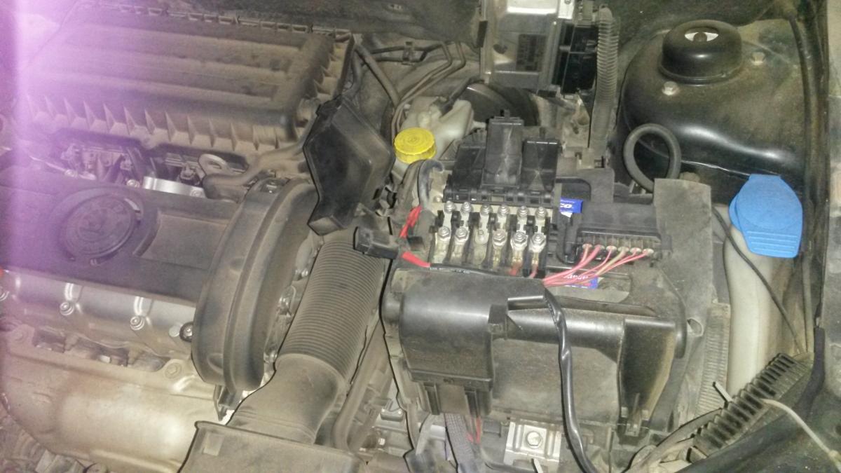

looks like a single issue causing both those. I'd check the fuse for the ABS before anything else, looks like something simple. Fuse number 4 in the dash panel fuse box.
None of the things mentioned in the first post could cause the ABS controller to fail.
+1 for a fuse, but my guess would be the 40A fuse (#10) in the fuse holder on the battery.
#7 in the fuse holder on the battery needs checking too, as it is possible for multiple fuses to blow.
The other two fuses are F4 and F48 in the main fusebox.
I already checked the abs fuses in the main fuse box #4 and #48 and they are fine.
The battery fusebox has only 6 fuses. Is there somewhere else in the engine bay that has more fuses?
I attached a picture of the only fuses I know of above the battery.
To the right of the six big fuse links, you will see six red wires entering the other half of the fusebox.
Checked them all and they look fine. Sadly I think fuses may not be the issue.
Is it possible that the aftermarket break pad sensor malfunctioned and the car wrongly thinks the pads are worn out so its throwing this error?
You can't always tell by looking at them - you need to use a meter on resistance or continuity. Im not convinced they are good.
The wear sensor is not related to the ABS unit - it only goes to the dash.
The next thing to check would the wiring from the battery fuses to the ABS unit and the ground wire(s) from the ABS unit to the earth point.
If it's not the wiring, then the ABS unit itelf is likely faulty.
You were totally right. It was fuses #7 and #10. They were not bad but one of them was not seated properly in its socket. Once I pulled them out and put them in again the dashboard lights went away and the abs is working great.
