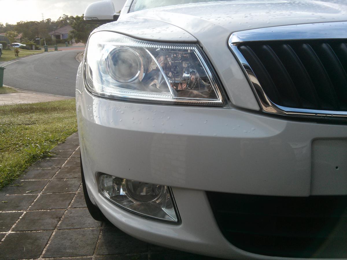

Attached an image because... I still love her.
