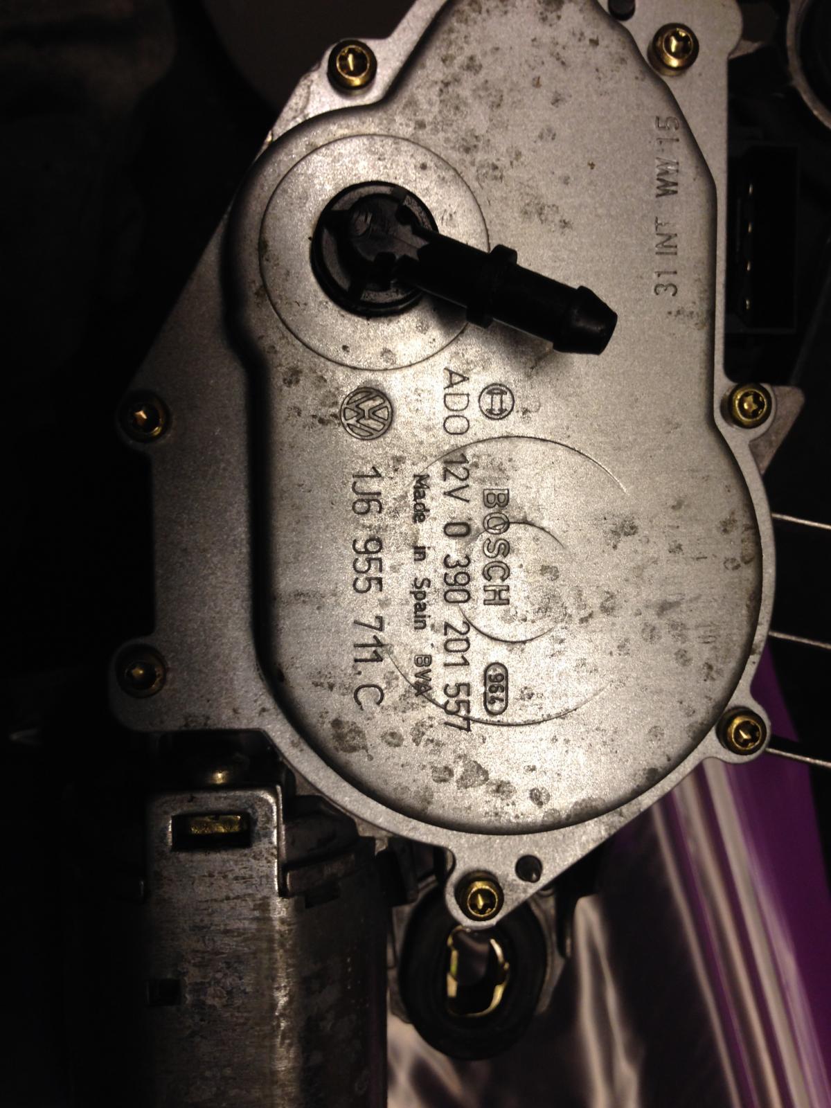

I bought a used on online, Bosch 1J6 955 711 C and it's not the right one.
What would the correct part number be for a 2004 Fabia VRS? Apparently it's a Valeo unit.

There are different variants which are VIN dependant. C, F and G revisions have been used although the G revision is most common. Unfortunately, you can no longer get the grommet that matches the one you have bought.

Mine is 1J6 955 711C, not sure what the difference is?????
That's the early one and was superceded by 1J6955711F. You also needed to change the grommet.
1J6955711F has now been superceded by 1J6955711G. You also need a different tube.

so will it fit?  If he uses my motor and his rubber bits?
No. The grommet and tube that works with his 'G' version won't work with your 'C' version.
You're trying to go backwards :(
